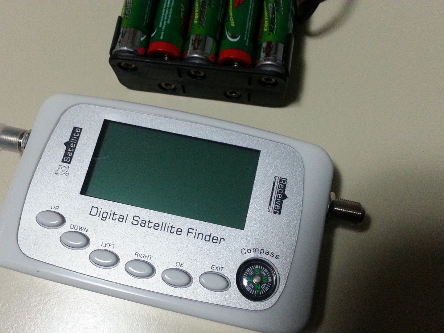

I recently bought an old fashioned magnetic compas to find the direction of the satellite. I have on occasion used an app on my samsung android called dish pointer pro. There are many web sites out there that help you find the direction and elevation to point. so you can get your settings while you have the internet. What I mean is if you know where you are going you can get the direction settings prior.
We were at Theresa Creek dam one time and a fellow camper put me onto this sat finder.

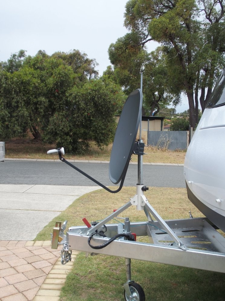

Thanks Tomcat. I'm not that concerned about how one finds the satellite with the compasses and all that, but rather if having the dish mounted in a fixed position such as the "A" frame is practical or do you guys need to move the dish about to get a good "line of sight to the Optus sat.
The unit I have has a strong tripod with holes already to mount/fasten on the base of each leg. If I drill and tap into the chassis of the van "A" frame it can be hard mounted as a Theft deterrent. There's no way I can see, to hard mount it on the back of the van, no structure strong enough to support it.

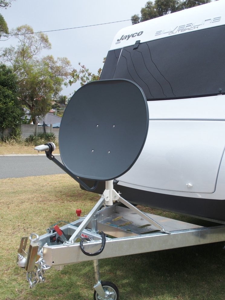

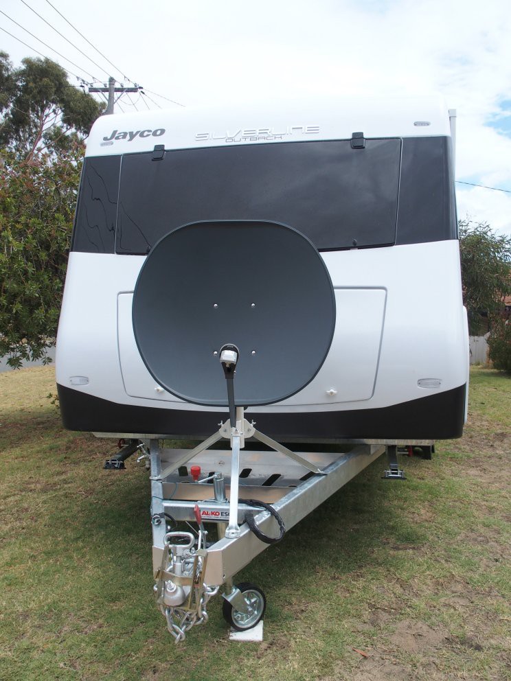

I use a single pole on the drawbar (mounted with a Jockey Wheel clamp) and provided i have parked without trees in the 'line of sight' to the satellite I have no problems setting up, it only takes minutes to do.
You suggested mounting your tripod to your drawbar, I would advise against this as the tripod is better carried in a compartment somewhere and used in situations where you need to get the dish away from the van due to trees or such.

Have a similar setup to Delta18, single pole on the A Frame with our 85cm elliptical dish. For additional stability have a tube going down to near the hitch and another tube to the side, both at around 45deg.
Just point the caravan in a North East direction to get a Sat signal when off the tug, when connected to the tug can still get a sat signal but the position of the van/tug is a bit more critical.

Got a German Deutsche Technologies Sat. finder. Has a TV screen set to Al Jasera news. The unit is pre-tuned to the correct satellite.
Couldn't be happier. 8 out of 10 it takes less than a minute to find the Satellite.

I posted those pictures to show where I could mount it, by screwing it to the "A" frame. Didn't put any comments because I don't think they would have gone down too well. Couldn't resize the images on the screen so gave up in disgust.
Chopit you must have the same tripod as pictured, Quite well made by todays standards. Just can't help the feeling I will have to pack it up every time we leave the van to keep "you know who" from worrying.
Moving about in the van has no effect on reception even without the stabilisers down.
I'll take a photo later when the rain stops.

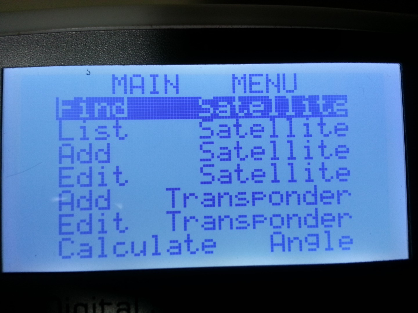

I have a compass but almost always use the WIKI CAMPS App sat finder which comes with WikiCamps
Takes me about 15 minutes to set the whole deal up on the Tripod with pegs if needed. Bit faster if I use the van mounted pole.
<http://www.wikicamps.com.au/settings/images/screen-satellite1.jpg >
http://www.wikicamps.com.au/satfinder.php
-- Edited by elliemike on Monday 7th of December 2015 10:28:18 AM
and with the same/similar Sat finder as Tomcat, there great.

We have a Z shaped pole mounted so that one leg of the Z points up and the other down on the rear right corner of the MH. The mount is fixed to the MH with a scaffold clamp the Z is a length of steel exhaust pipe, bent to shape by the local exhaust/towbar maker, because back in 2007 they hadn't invented manufactured ones yet but you can now buy them from caravan accessory shops. This allows us to swing the dish in a 135 degree arc, so that almost any way we park I can point the dish towards the satellite. Access Antennas have a very good sat finder called Marriage Saver. $173 of Ebay post paid, well worth the price. You still need a good compass and angle finder VAST help gives you the 3 settings you need. It very rare that you will travel far from the previous days settings, so if you take note daily and start from the last known settings you should have it up & running fairly easily.
Mounted on low tripod stand, takes around 5 mins to deploy and be up and running.
Just posting a couple of pictures.
