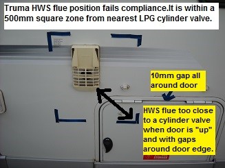

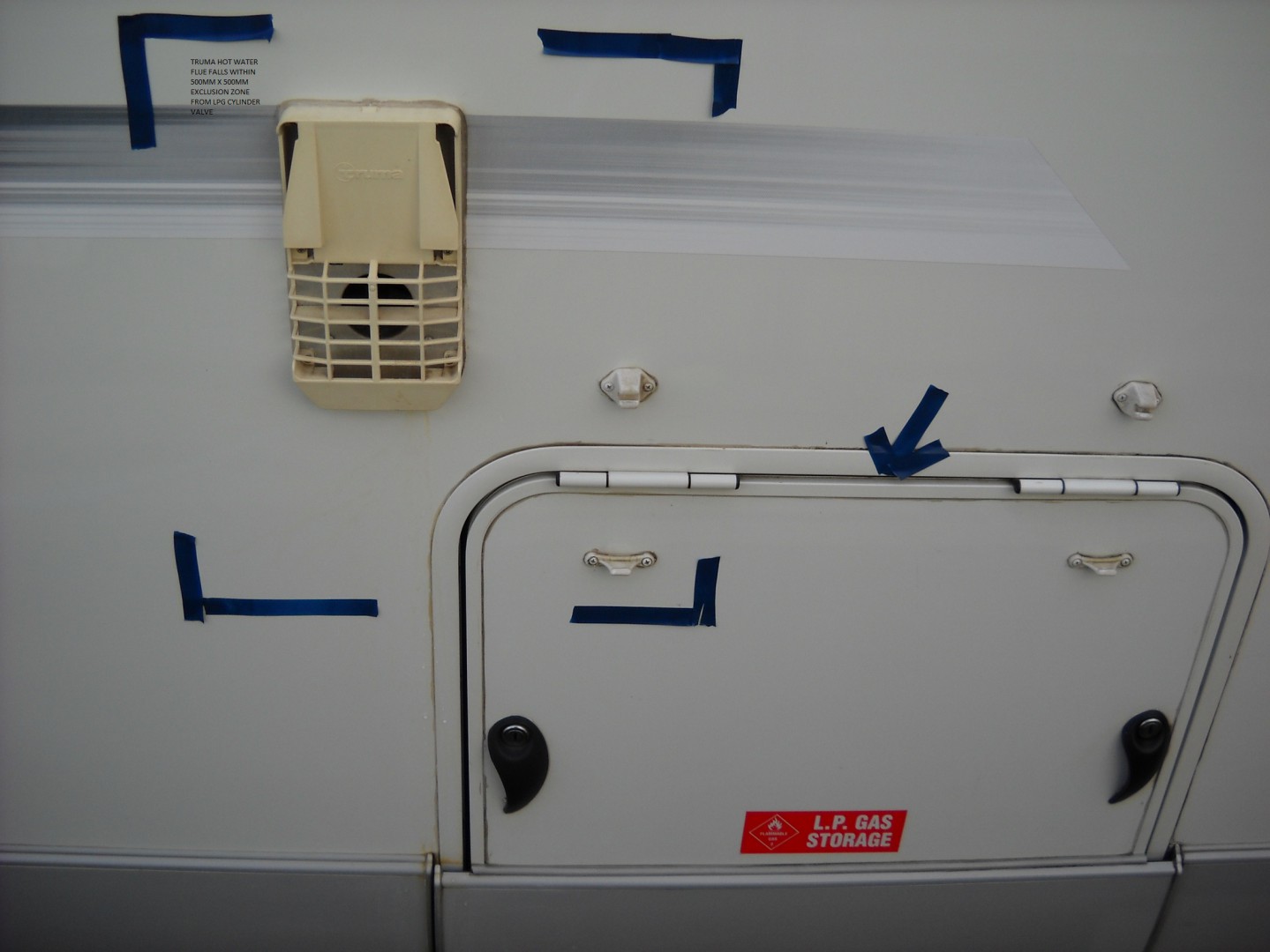

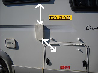

AS5601-2004 shows compliant location of Hot Water Service (HWS) flues. They must NOT: (1)be closer than a minimum 500mm below an openable window and, (2) be located within a 500mm x 500mm square exclusion zone from a LPG cylinder valve. The squares hypotenuse measurement gives a swinging 700mm radius separation distance between the HWS flue and a cylinder valve. This 700mm requirement has NOT been 100% complied with.

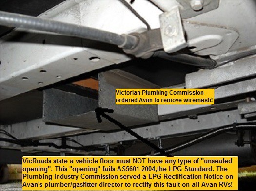

*vent hole in floor! Avan's lower LPG airvent is built as a vertical shaft "hole through the floor"!!??

*Flue photo
