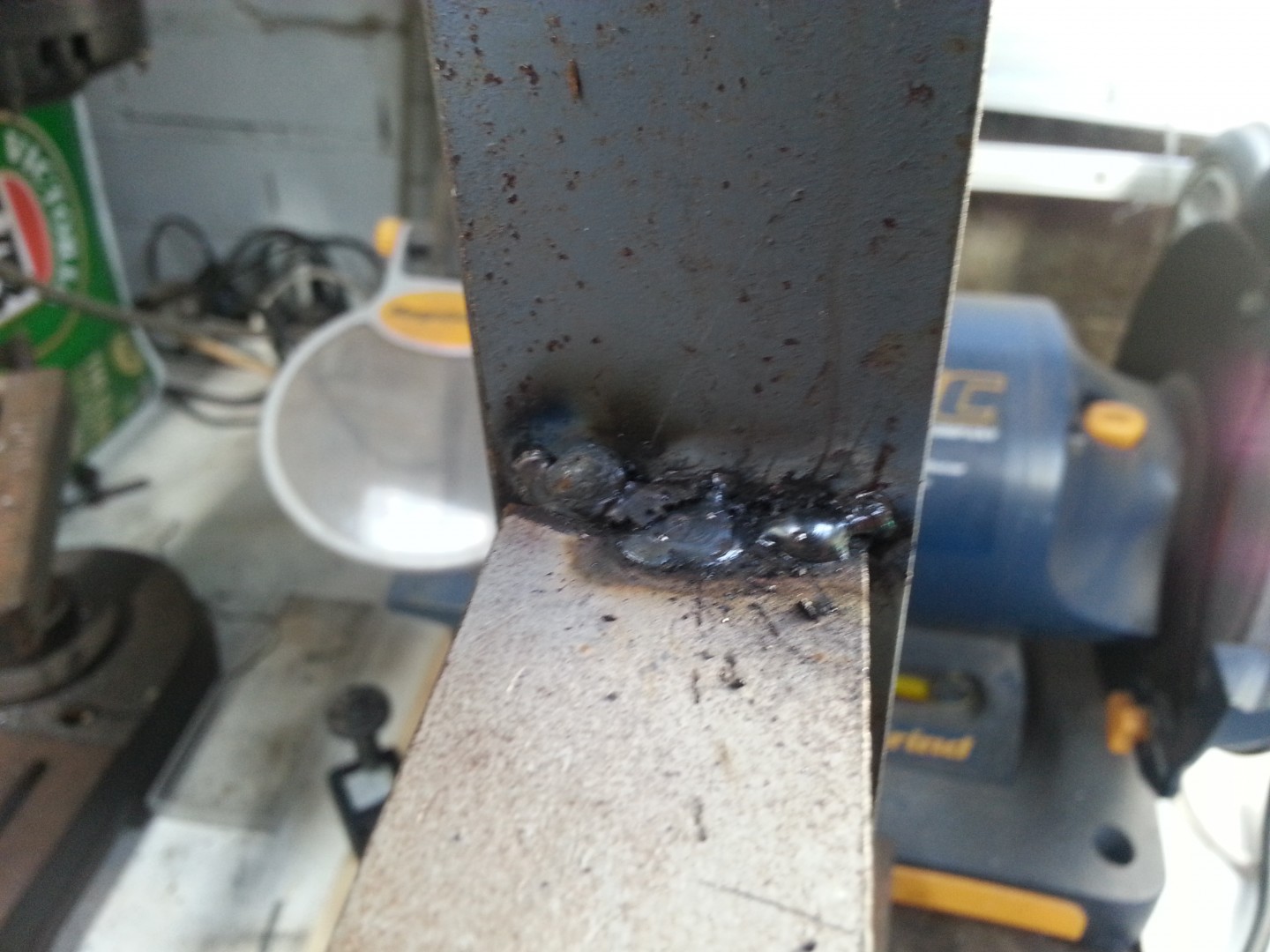

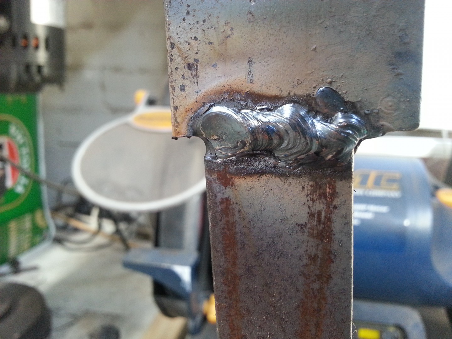

landy said
07:45 PM Dec 6, 2015
I have just done a test with my 2kva Honda and an Ozito 80 amp invert-er welder, that i keep for small jobs about the place. I ran a good 2 inch stitch weld between 2 pieces of box section with a 3mm wall, with no problems at all using a 2.5 mm rod. hope this helps. Landy PS welder cost about $120. 00 from Bunnings.
-- Edited by landy on Sunday 6th of December 2015 07:49:06 PM

landy said
10:23 PM Dec 6, 2015
Hi frank, It did not seem to bad it took a few scratches with the rod to get it started but as soon as the revs came up on the motor it ran free and smooth. obviously it made the motor work but no worse than the microwave in our van. all round I was very impressed. Landy

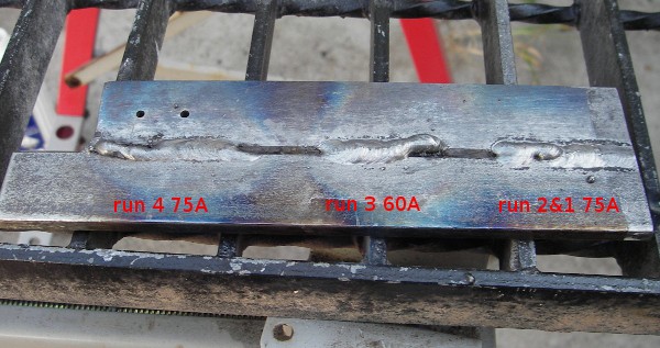

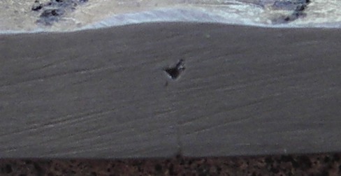

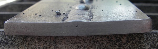

03_Troopy said
09:48 AM Dec 7, 2015
OK, seeing as landy has already tried 3mm, I gave it a go with 5mm just to see how it would go.
Welder is a cheap Chinese "140A" Inverter welder.
Honda Genny set with Eco Throttle OFF
5mm mild steel with a bevel ground on the edge.
I had the welder set at about 75A according to the dial on the front, found it hard to strike an arc as the genny loads down under the current draw. For run 1 I ran about 25mm of bead till I lost the arc (part of the run was cut off to show the cross section).Tried to carry the bead on with a second strike at run 2 but lost the arc again after about 10mm. The bead looked pretty good though.
I dropped the current down to 60A, harder to strike a decent arc, as can be seen on run 3, where the arc was weak and favoured one edge. The bead looked good although slightly more rounded, but I lost the arc after only a short run.
Back to up to 80A ish for run 4, but the genny struggled and it was hard to strike a decent arc again till the genny settled down, and I lost the arc after only a short run.
As can be seen from the section cut through run 1, the weld didn't fully reach the bottom of the bevel which was about 2mm deep.
So, in conclusion, I'd say if you bevelled both sides, and made a pass on each side, the weld would hold. But 5mm is probably out of the limits, especially with the amount of heat required to overcome the heat sink effect of the mass of metal.
As for the Honda EU20i generator being able to supply the required current, I don't think it's really big enough and struggles to supply enough current to make a decent weld for any length of run. I'd say 3KVA would be a much better option. Interestingly, CIG recommend a 5KVA generator for their Weldskill 100 Inverter Welder.

landy said
11:27 AM Dec 7, 2015
Good on ya Troopy shows I must of been near the limits of what the geny can push out. Personally I don't travel with a welder and would use a couple of batteries if I needed an emergency repair, But I am still impressed with what the Honda and the little welder could do and in most cases would get you out of trouble. Landy

Then I started the 2Kv Honda and plugged into there and halfway through the weld the Geni overloaded. I restarted the Geni and turned the Control on the welder from 80 amp to 55 amp. It then did a 90 deg weld without overloading the Geni. This is the first picture.
Tomorrow I will get some 2mm electrodes and try them with the welder turned up full. All in all it looks promising.
Just another point I noticed the Geni did not ramp up while making the arc but only after the weld was well and truly underway.
I would not have gone out and bought the welder if not for the info from you guys so thanks for that. Tom PS Im a crappy welder.
