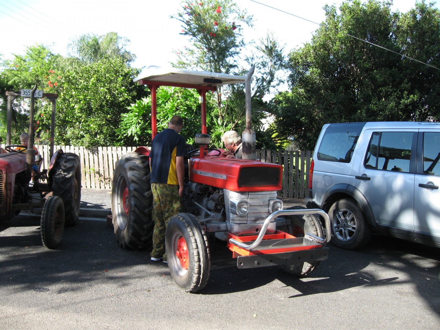

The original "bull bars" were made to , stop cattle heads from damaging radiators , And lights .
when you were in isolated spots , so you could get into town & patch things up .
I have had "bull bars" on all my 4b's . except this one . It has a "nudge bar" a Steel nudge bar.
solid as a corner post. when "herself" bought her Xtrail , had a xtrail nudge bar fitted , looks good.
YES , I would put one on . a Good nudge bar , not one like this.
-- Edited by WobblyNut on Thursday 3rd of December 2015 05:18:20 AM
as you can see , th grader blade nudges ,
the chrome bit "tarts it up"
