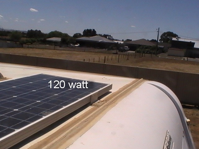

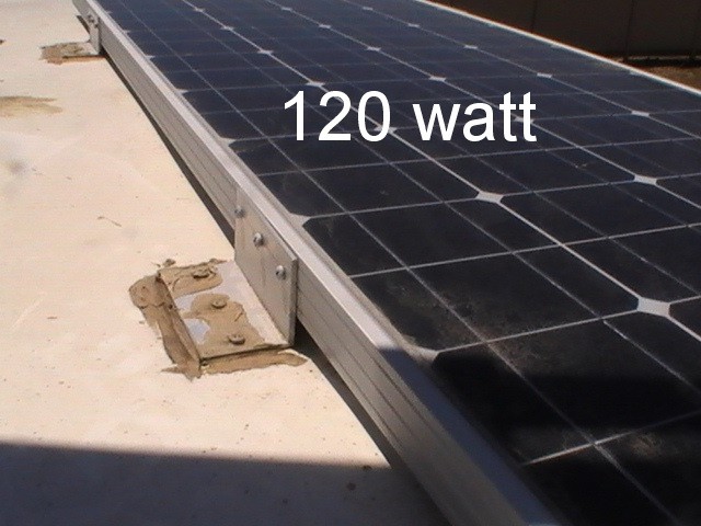

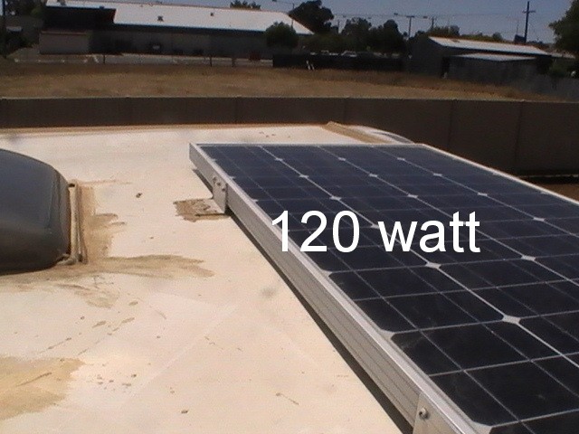

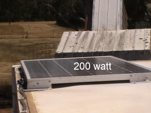

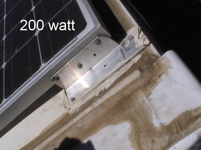

I have Tom. Jayco Ballarat mounted a 120watt panel when we bought the van, and recently I needed to add another panel. I bought a 200 watt and mounted it on our 24' Sterling. I did have a thread here on the forum BUT cannot negotiate my way thru this forum to find it!!! I will get the ladder out tomorrow and take some pics to show how Jayco and myself achieved this.

Here we go Tom. You can find more solid beams near the roof openings. I used the roof where the top of the wall meets the roof, and more solid areas around the roof openings. I took some video as well so I will see if I can get that up.

I have a 2010 Jayco Sterling with 500w of solar fitted to the roof, I am going to add another 200 watts soon. I mounted the panels on aluminum angle with 1 screw per bracket to mount to the roof. The screws where 10mm long S/S screws. I used Sikaflex 11FC to attach the brackets to the roof and the screw was just to help hold the bracket down to the roof while the Sikaflex cured. Have traveled 20,000 klms since then and never had a problem. I did make certain that the holes for the screw had a bit of Sikaflex in them so I would not have a water leak problem.
The next lot of panels I am going to just glue the brackets straight on with some weights on them until the glue is cured. No screws at all.

Make sure you use fixings that allow an air space under the panel(s) - they work more efficiently when air can circulate under them.

I have 4 panels on my van roof totaling 500w.The panels are attached with aluminium right angle brackets that are attached using Sikaflex construction adhesive 11c.
