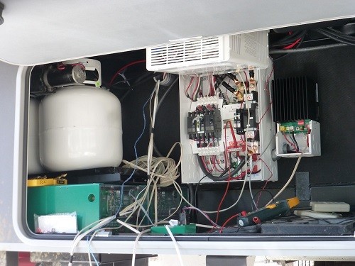

It should be easy to keep battery suite temperatures above 0 C and below 49 C. The main thing with the higher temperature is to have a ventilated battery box. The peripherals can generate a lot of heat. Attached is photo of the front bay with two of the LFP batteries (each is four CALB cells in series) shown and the electrical system under construction. These can provide a lot of heat
