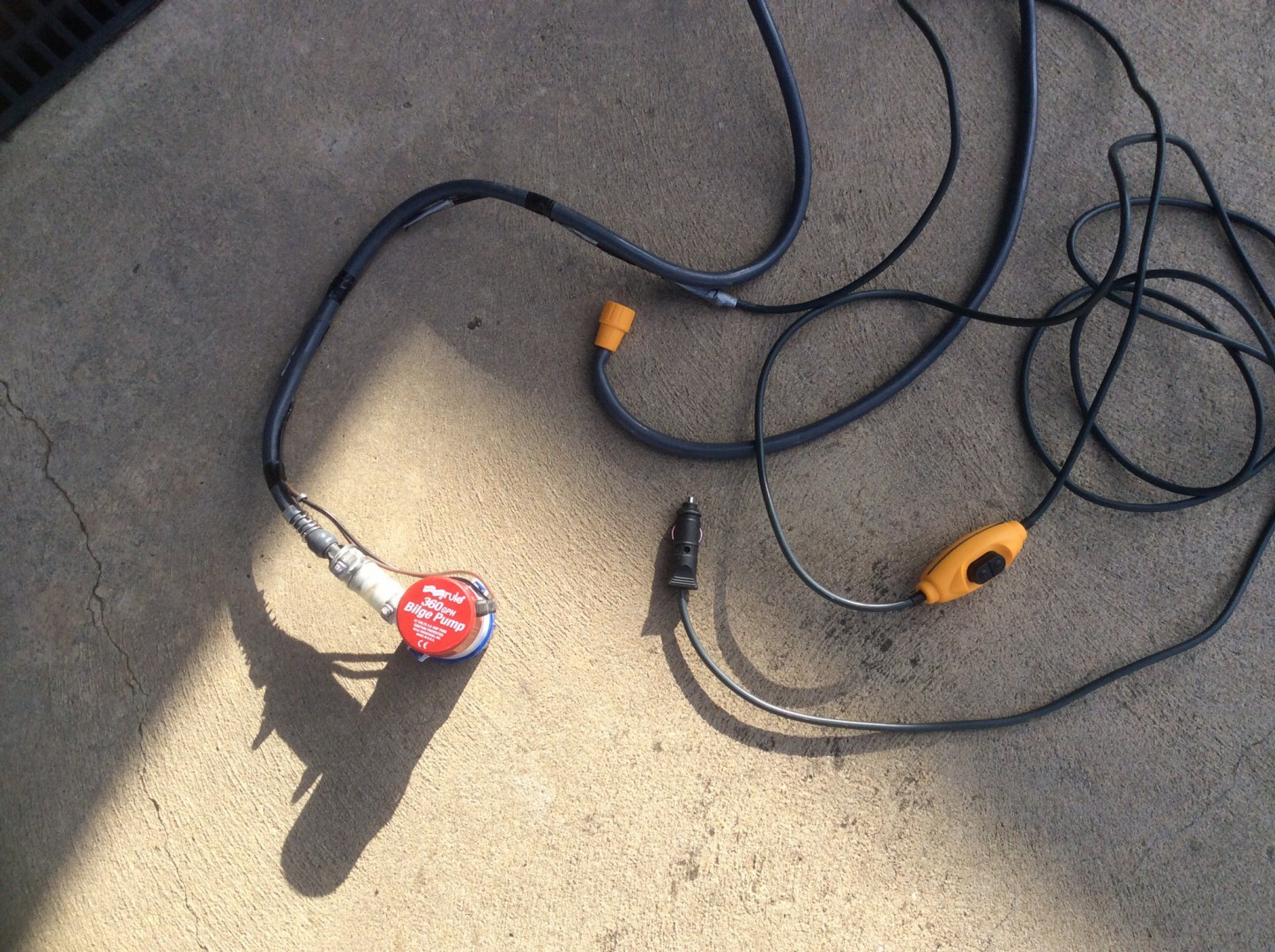

Hi Val
Go to any caravan accessories place Ray's out doors bye yourself a 12 volt portable shower, cut the motor off it go to a boat place or BCF and bye a Rule Bilge pump cost about $30.00wire it on where the shower motor was,this bilge pump will pump 7 meters in height and will pump 360 gallons a hour I think about 5ltrs per gallon, just remove the shower head and fit an ext of hose or fit it at the pump,this bilge pump won't hert if run without water for short time, (RULE 360 GPH BILGE PUMP ) red white and blue in colour, the portable shower Setup has a on off switch in line, i would run the water through a filter before going in the van,hope this helps.
Lance C
Lance C
A couple of pics.
Lance C
