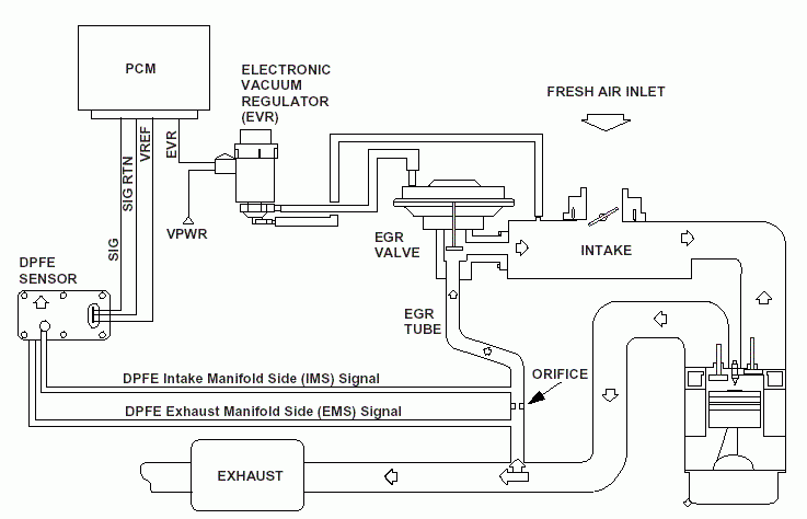

<quote> EGR valve blocker has any one got information as to effect on the performance of your vehicle </quote>
For the moment lets just ignore the environmental and emissions issue, or the now unroadworthy condition of your vehicle as it now now longer complies with the original design approval.
Your ECU is tuned to expect a specific range of readings from various sensors on your entire drive train.
If you mess with things like the Exhaust Gas Recirculation valve you can expect the ECU to take corrective action.
This includes enriching the fuel mixture resulting in greater fuel consumption and less power, and displaying the FI error light on the dash.

ECUs on mainstream vehicles are not that clever. They actually operate around a set of pre-programmed instructions. Removing/blocking the EGR valve is not one of those. As a matter of fact on a Landcruiser V8 diesel if you completely block the EGR valve you will get an error and send the ECU in limp mode. This is because the ECU has encountered a condition it does not know what to do with. The way around it is to make a small hole on the blanking plate to in order to fool the ECU into thinking all is good. May be different with the model due to be released son carrying a DPF.

It lets inert gasses back into combustion chamber to prevent heat and assists in burning the fuel in chamber .. While adding lots of timing to burn fuel at light loads .. This helps emissions and fuel economy .. If working correct .. Discnnecting EGR can cause detonation / engine failure .. On diesels they can have issues blocking up.. On petrol engines .. It can reduce detonation big time.. Being an inert gas it doesn't burn and assists catalytic converter from over heating .. Usually switching off and on ..

Firstly, the name is misleading, it does NOT recirculate gas from the exhaust.
No engine is 100% airtight between the combustion chamber and the crankcase. Small quantities of exhaust type gases AND air:fuel gases (depending on inlet or exhaust stroke) escape past the pistons and rings into the crankcase. On older engines these gases were simply allowed to escape to the atmosphere via some sort of crankcase breather hose or pipe, contributing to air pollution.
Modern emission standards no longer allow such wantonly irresponsible designs, so a valve and piping is fitted to syphon off these gases back into the engines air intake system.
As these gases contain a mixture of exhaust AND unburnt fuels, this has to be factored into the ECU mapping for the fuel injection system on both petrol and diesel engines. Manufacturers go to great lengths to test their vehicles for optimal power whilst still meeting emissions laws (unless you happen to be the peoples car in which case you cheat the system and market your vehicles with lies about how good they are)
If you block your EGR you not only leave these gases to build up deposits in your crankcase and oil (which is a darned sight harder to clean and possibly a lot more expensive) but you mess up the fuel mapping, which the ECU will via numerous sensors try and self correct, because the ECU thinks the mixture is now too lean, and therefore it lengthens the injector open times, resulting in marginally increased fuel consumption.
And, I still haven't mentioned how your modified vehicle is now no longer as it was when it received design approval therefore by law it can be defected and put off the road if spotted by Mr Plod or some other authorised officer.
Hmmm--
More informed comment
There are both EGR valves and PCV valves.
EGR exhaust gas recirculation.
PCV positive crankcase ventilation.
TDI diesels have a complex requirement for the latter because of the high intake pressure from the turbo. However they do both things and for different reasons also. Probably best described now as systems. The valve is not acting alone but is integrated into the overall electronic control system.

Actually, that's exactly what the Exhaust Gas Recycle Valve does, hence the accurate name of it.
Hylife . Your getting PCV and EGR mixed up..
