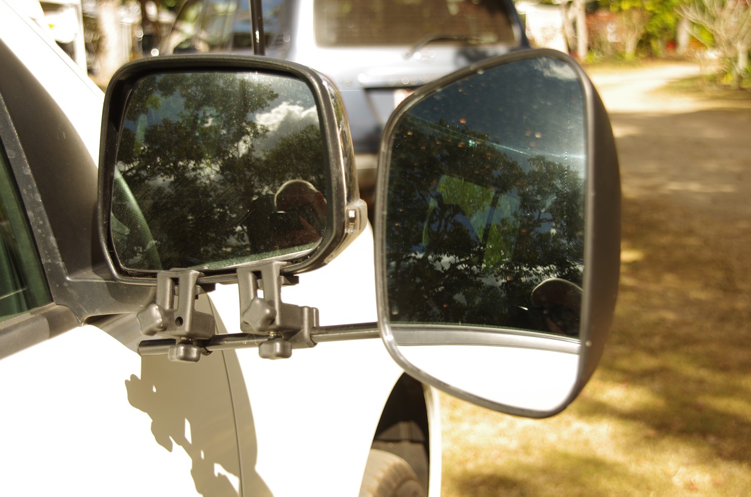

just read the search replies for mirrors have a question ( yes another one )
have 2 sets of mirrors one older set has a clamp like part that fixes to mirror and has rubber straps that go over car mirrors to hold it which i have used and work ok
just got a set of milenco ones that hold on with clamps
question is i really find that with both sets that when connected ( with the clamps ) they really give no space for the normal car mirrors to move ie the clamp /holding part jams the mirror
am worried that the towing mirrors will break the cars mirrors because of the thickness of the clamping part sticking into the mirror covers
has this happen to anyone or am i again worrying over nothing ?
if people dont get what i mean can post pics tomorrow

G'day David
I have been using Milenco mirrors for a couple of years now and find them excellent.
I clamp mine to the bottom of the mirror and you can see in the attached picture how it looks. I have had no issue with the clearance interfering with the vehicle mirrors. In more than 25,000 km I have never had a mirror fold back while travelling.

I too now have Milenco mirrors. Tried clamping on the bottom but then changed to the top, which seems better for the Patrol. They had been coming loose when clamped on the bottom. Might have to try DD's solution.
In both cases I have trouble with the clamps fowling the normal mirrors but that is no real issue.
Unfortunately the Milenco on the drivers side still folds part way back with the draft of some passing trucks. A stretch strap to the CB aerial bracket fixes that. I'll have to look at tightening the Patrol's mirror fixing bolt to see if that solves the problem.
