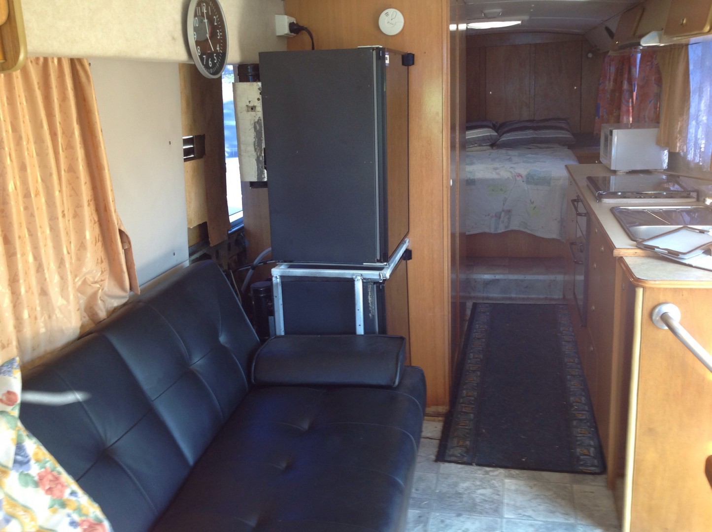

One of my fav things I do is fabricating steel.. I used 25 X 25 square pipe and made a frame .. Using same bolts through the floor and wall to hold .. Screwed a steel plate sliders to sit between bed and frame and L Brackets each side to move a few mm out from wall to lower .. Drilled L bracket through frame to hold in place when folded up.. But doesn't really need it..
Worked out much more secure as frame is bolted to side wall as well.. Being bus I had to contend with front wheel arches..
11:58 PM Nov 14, 2015
This is half way through .. I moved fridge on top of freezer to make better use of space .. If your floor is flat ? It makes things way easier..

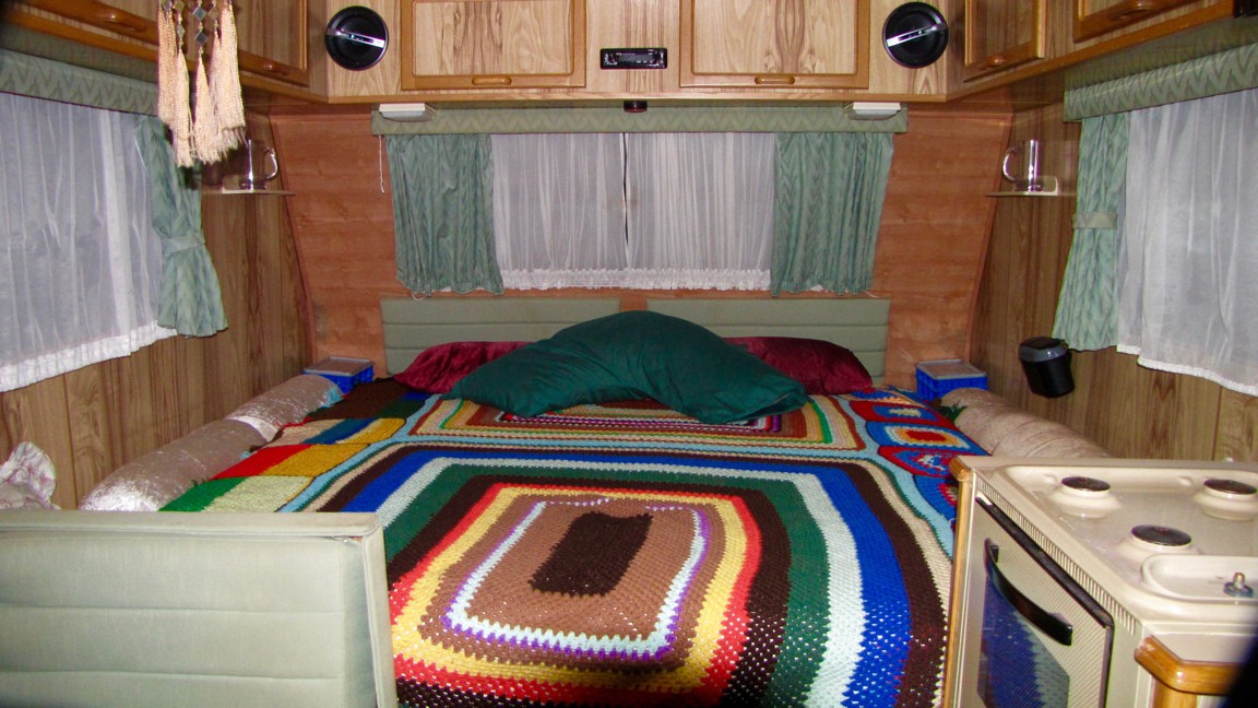

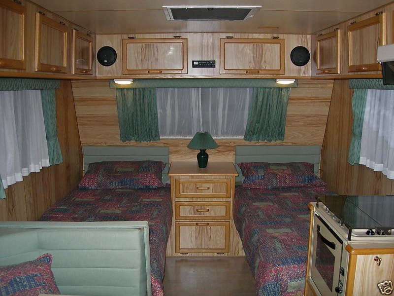

We have a 17 foot 1996 caravan which we bought 2nd hand about 6 years ago and it came with 2 double beds separated by a bedside table.
We were going to travel Australia for 2 years (which we did) while our house was rented out
We didn't want separate beds for that long so a friend and I ripped out the single beds then joined them together, turned them around 90 degrees then mounted it on beams spanning from what was left of the left hand single bed frame to the right hand bed frame making a king size bed. It fits king size fitted sheets perfectly.
It did leave a gap of about a foot either side but as water tanks on one side and the water pump was on the other side we couldn't have a skinny walk way so we just made long shelves running along either side at an equal height to the bed base which have bolster cushions running along them for aesthetics and comfort.
The photo's show before and after shots.
I haven't got around to it yet but I will be putting a pair of hydraulic lifts to make raising the bed easier.
We love the double bed as we can be together if we want to or well apart during the heat of summer and we rarely disturb each other.
The only drawback is it's a bit of a pain making the bed.
Hope this helps.

Love the conversion

Hi Jon
Thank you for the info.
I love your crochet blanket
Hopeing pic explains better..
