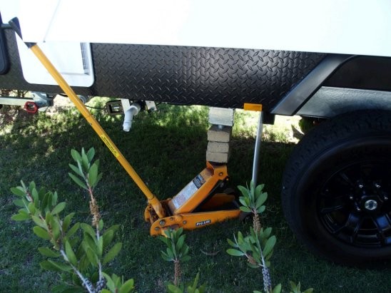

09:57 PM Nov 17, 2015
mjt57 wrote:
Why haven't the van manufacturers designed the stabilisation jacks to take the weight of the van? To me they sounds the ideal way of levelling it.
Because caravan chassis are too flexible to have the van supported primarily in the middle some times and then at the ends on other occasions. The one time principle of Caboolture Caravan Repairs (cabcar) used to frequent one of the other forums. He gave specific warnings about supporting vans by their ends. It does not take much to stress the body of a van by lifting the van at the ends.
I have noticed this edffect in the three side door vans I have had (and one of those was only a 15' van.) In each case I marked a line across from the door to the door jamb near the lock. If I apply too much pressure on the rear steadies the movement in the door shifts the door 2 - 3 mm. The 15' van had the old lock with the toothed wheel striker. The plate on the door jamb had to be very carefully positioned so the door section would not foul the other section when closing the door.
If a heavy handed extension of the rear steadies can flex the chassis that much, just imagine how much the chassis will flex when supported at the ends. I'm sure the continual flexing the body with the chassis flex would do to the sealing of the van. It's hard enough keeping the body waterproof without adding that to your woes.

jomac74 said
10:07 PM Nov 17, 2015
Iana - I think using bricks like that is very dangerous and risking a serious accident - get some chocks, lot less worry

iana said
08:04 PM Nov 24, 2015
Nobody has commented on my last question.
This is the part that has me thinking, when picking up both our caravans, new, the salesmen made a point of saying that the stabilizers are just for that, and not for taking the weight of the van.
So if the van is sitting on its own suspension, and the stabilizers are down, won't the suspension drop as more persons enter the van, and the weight is then transferred to the stabilizers?
Without hard jacking the chassis, how do you stop that from happening?
And Guys n Girls I am not that stupid, I put the picture of the trolley jack in to tease a few people.

As well as all the above comments, a jack welded on top of a jack stand is dangerous. Jack stands are usually barely stable at their maximum height. Extending the max height will make them unstable at the least, and deadly at the worst. Even if you don't go beyond the maximum overall height of the jack stand, any inherent play in the jack mechanism will be magnified by the extension.
Edit:
Another thing to consider is that jack stands are meant to be used under a reasonably level vehicle. When you have a jack attached to the top of the stand, you can have a situation where the tilt of the van while jacking, will put excessive lateral loading on the stand, causing it to fall sideways.
-- Edited by jomac74 on Tuesday 17th of November 2015 10:08:55 PM
