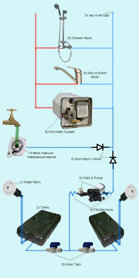

KevinC said
06:47 PM Nov 12, 2015
Tanks can and do overflow. (If your van has separate taps for tank or mains, then read no further ... this doesn't apply to your van. But if you have sink, shower, basin taps that deliver water from both tanks or mains, then this could be your next van problem).
The two apparently separate systems come together at the pump. On the delivery side of the pump, the pipes are pressurized either by the pump or mains pressure. The pump has a non return valve, otherwise the pressure from the mains would force water back through the pump and into ... the tank. Simple. If you suffer the indignity of your tanks overflowing onto the ground through the breather when you're in a caravan park, as indeed I have, then you can replace the pump, (or claim it under warranty if you're lucky), or cut into the hose that delivers water from the tank to the pump and fit an external one way valve there. But make sure if this becomes a DIY project, that you put the valve on the inlet side of the pump.

KevinC said
10:55 PM Nov 12, 2015
Sorry Baz, what I was trying to say was the pressure regulating devices can be faulty and reduce town water pressure even when they're clean. The reason the device is there in the first place is because excess pressure in the system can overcome the non return valve in the pump. And just to make things worse, the non return valve in the pump can fail even without excess pressure. So even if your pressure regulating device is good, the associated pump problem can still occur. I've been seeing this as one problem because the two issues are so closely related, and I've had both.
The non return valve should be on the discharge side of the pump.The diagram of how water systems below was taken from this link.
Yes Peter, I've also heard that, but I've chosen the delivery side. The reason is that if the valve is on the inlet side, the pump will never want to turn on because the switch will always detect pressure. If the valve is on the discharge side, as some suggest, then the pump must be turned off so it won't periodically turn on to maintain pressure, and pumps aren't perfect so this could happen. And it will probably happen just after midnight.
I think it's a minor point, and it's certainly not something I would get undone about. I can't in all honesty recommend something I haven't tried myself and my installation is working well (so far at least.)
