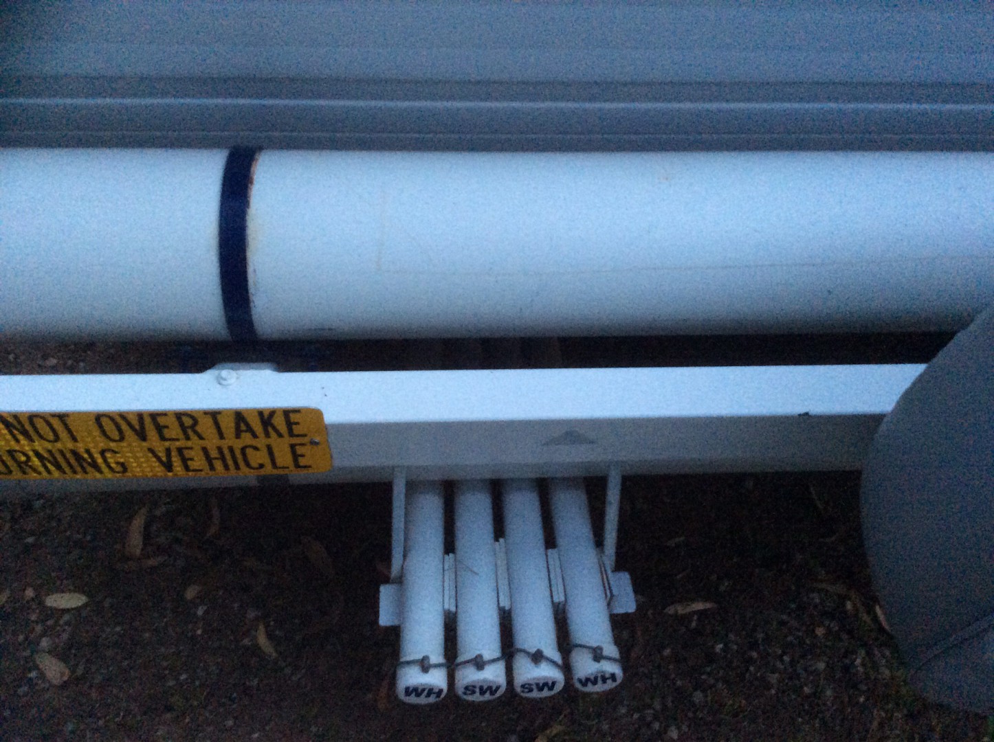

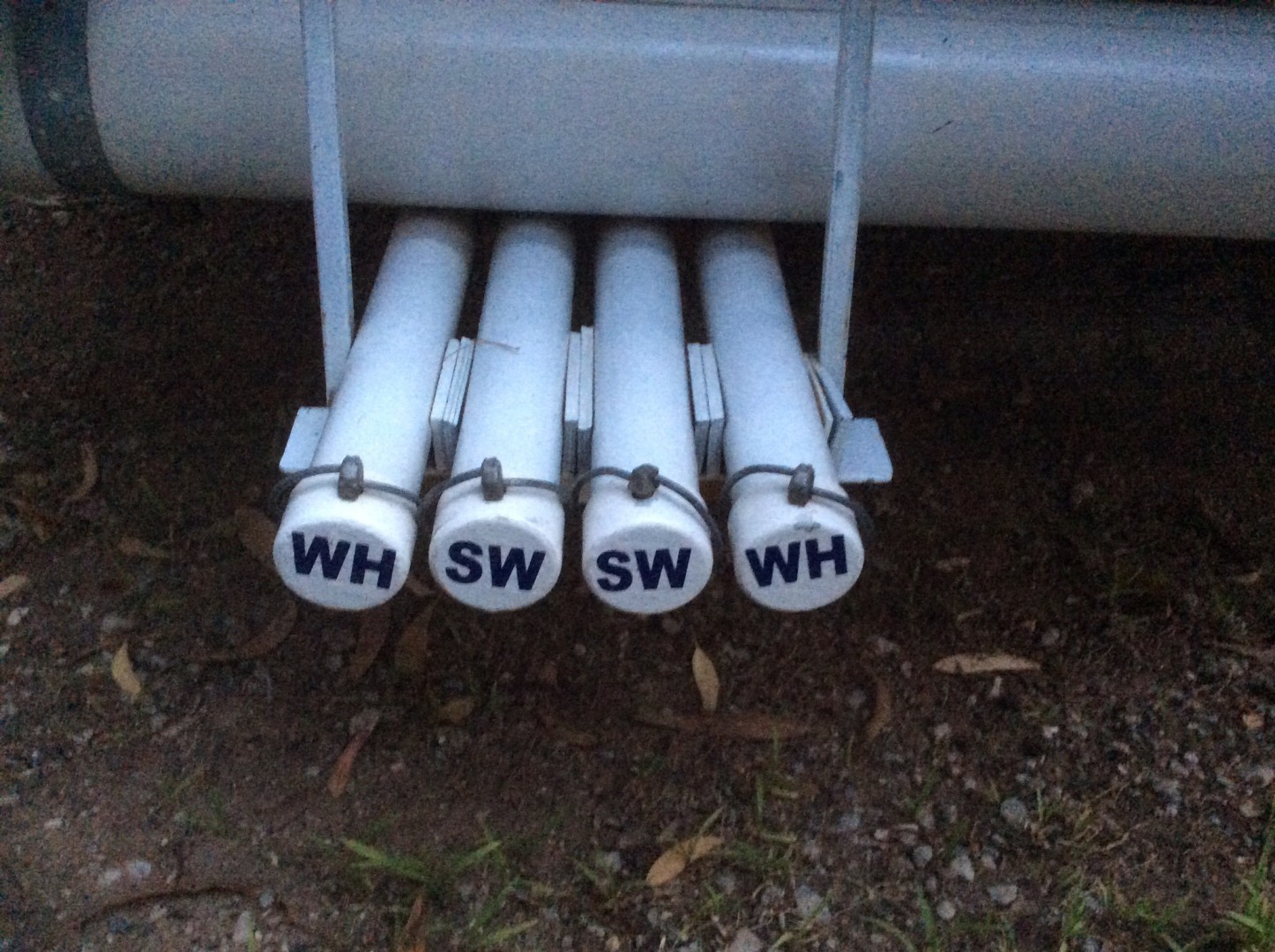

Sullage hose in the boot???
I store mine under the van, have access to 1 side of the hollow chassis rail and have added a length of 50mm conduit along the outside of the chassis rail with clips. So from the front double the hose in half and poke both ends into the chassis and conduit respectively, all the way and then secure the front (middle section) with a bungee strap.
No stink, no need to drain and easily out of the way. twice the length of the van so plenty of length as required.

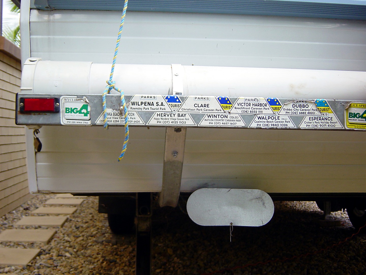

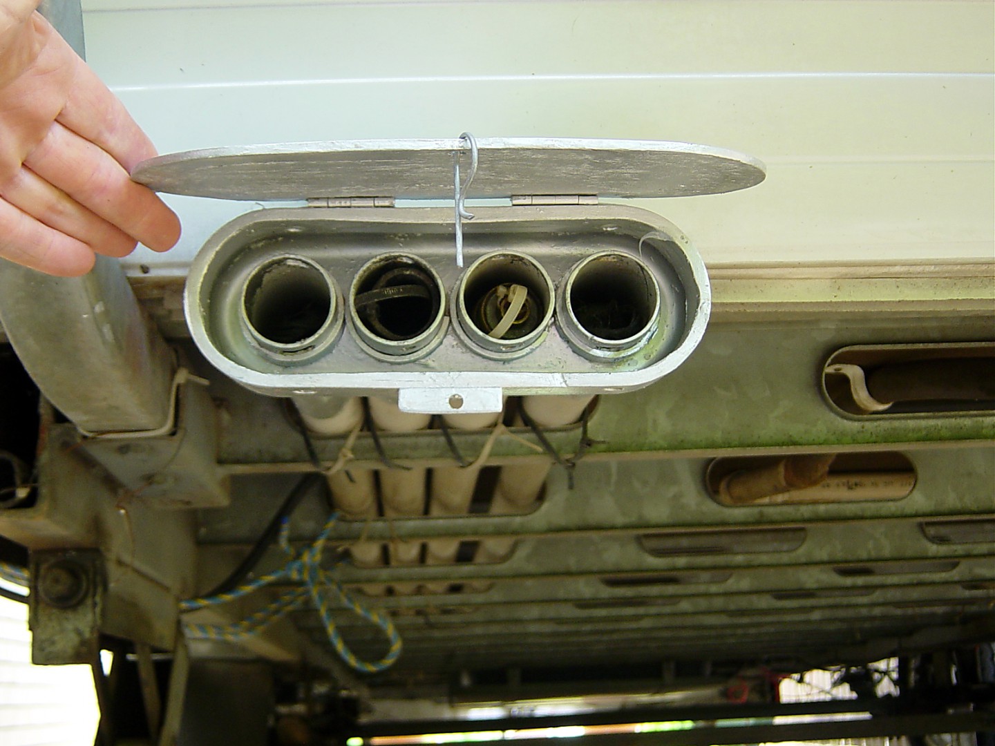

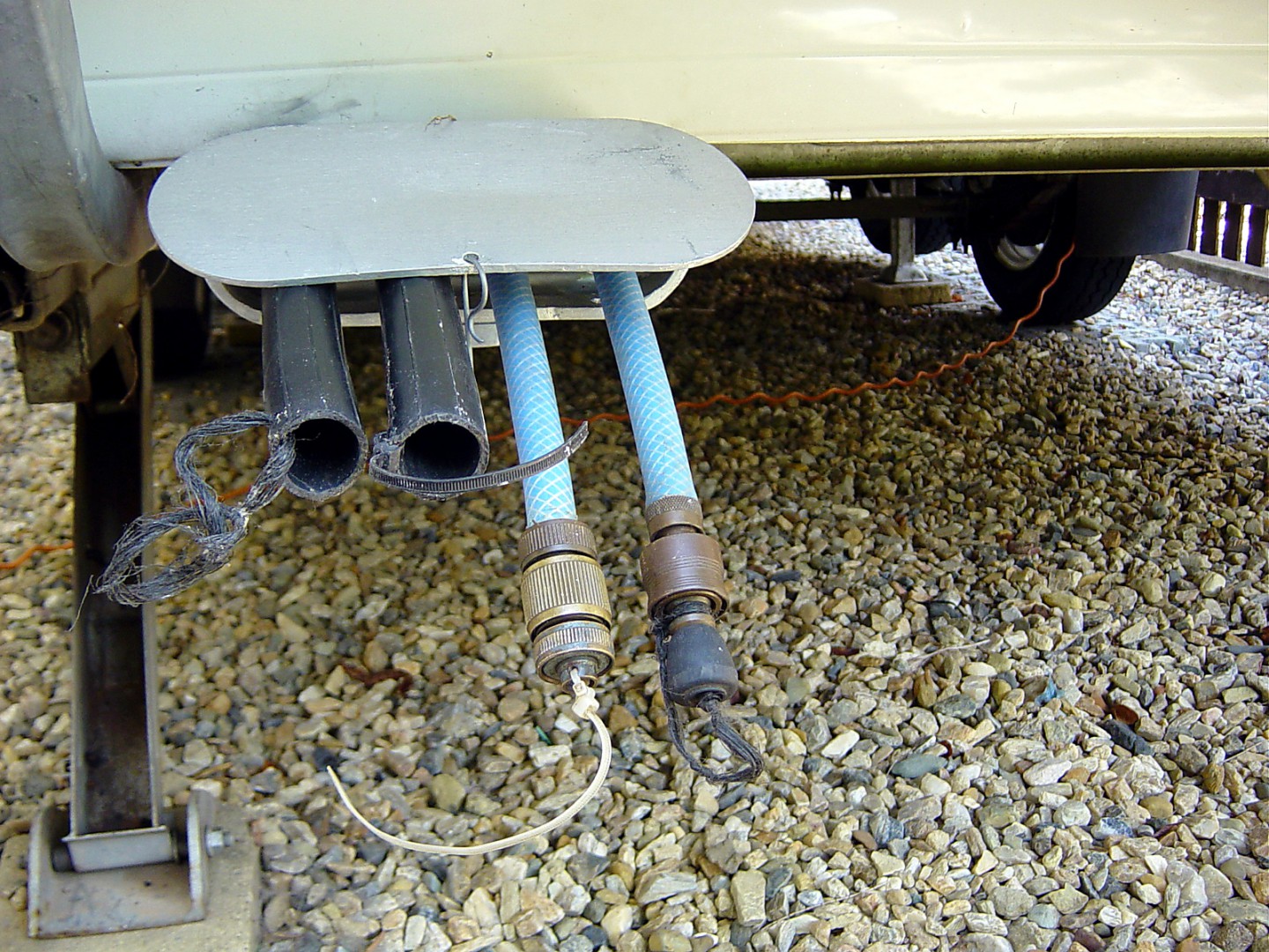

I purchased a black waste water hose that was smooth on both the outside & inside ... 15 years ago. I think that it is readily available in light purple.
I store it in appx 7 meter lengths in conduits under the van. It would probably develop kinks if I tried to roll it up. Joins together with short lengths of conduit.
Before returning it to the storage conduit after every use, I wash it thru with water from my van's 'A' frame tap until it runs clear & then wipe the outside as I feed it in to the conduit. Still as good as new.
Never had any pong.
