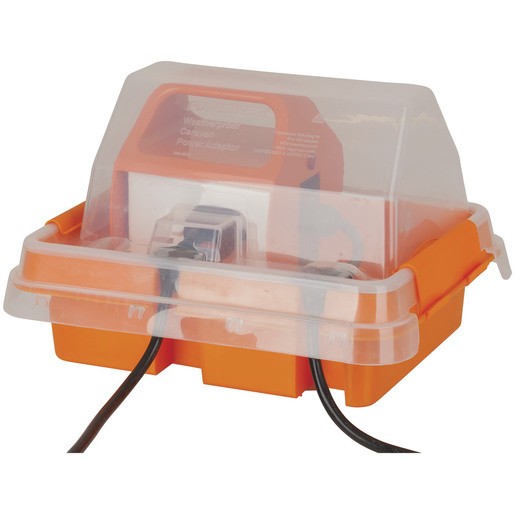

J. If your friends have a 15 amp outlet then all will be fine.
If not you can purchase a legal adaptor to do the job and there are several models at varying prices
One like this is about $129 at Jaycar
Perfectly legal and weatherproof.

I just bought it on EBay for $69 which included postage, but without the waterproof case.
J.
RV Power Solution 15A TO 10A Adaptor New 240V RCD Caravan RV Powertech MS-4044

Yes, David it's the same as sold by Jaycar, but without the case.
I too wondered how it would affect the house electrics and that was the reason for my question. Better to do it right though.
There's a YouTube video of a Jaycar bloke talking about it and the above appliance.
J.

As I understand it the mini ampfibian is not weatherproof, I am happy to be corrected on that.
the jaycar unit is a new model and is weatherproof.

KFT we have an ampfibian and they are all waterproof - just a little more expensive then the jaycar one.

KFT is correct, the Ampfibian Mini is NOT weatherproof.
From the website:
The Ampfibian MINI is for people who want a high quality Australian made product, but don't need the weatherproofing or heavy duty industrial features of the RV02-MAX
And NONE of them are waterproof, the RV02-MAX however, is weatherproof to IP33.

A standard power point is restricted to giving out 10 amps. A standard caravan cable and setup is for 15 amps. Caravan parks have 15 amp power points and a house may have these also but they are not standard. Legally you may not connect a load that will draw more current than the power point is designed for, for safety reasons.
However how much power you actually use depends on what you are using in the van. If you use too much power at once, eg a jug and a toaster and a fridge and heater etc, then the caravan circuit should "trip the breaker" and switch it all off. If you are only on a 10amp power point then it will not cut out at this low current and it MAY damage something. That is why you would use one of those new style 'adapter units' to ensure the current will stay below the 10amp limit or it will cut it off. That is then legal and safe to plug into a 10 amp standard power point. It will also work if you do not have a complete set up in a tent or simple camper etc that you also wish to use at a house.
I hope this may be clear for non technical people.
Barb
From the website:
Ampfibian Website
