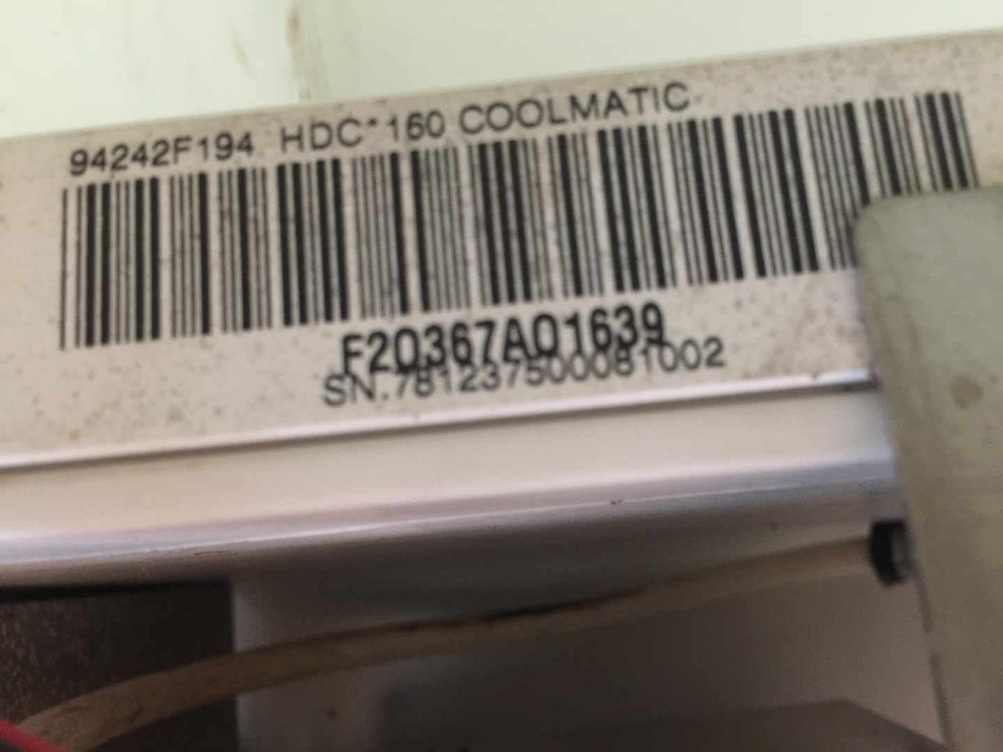

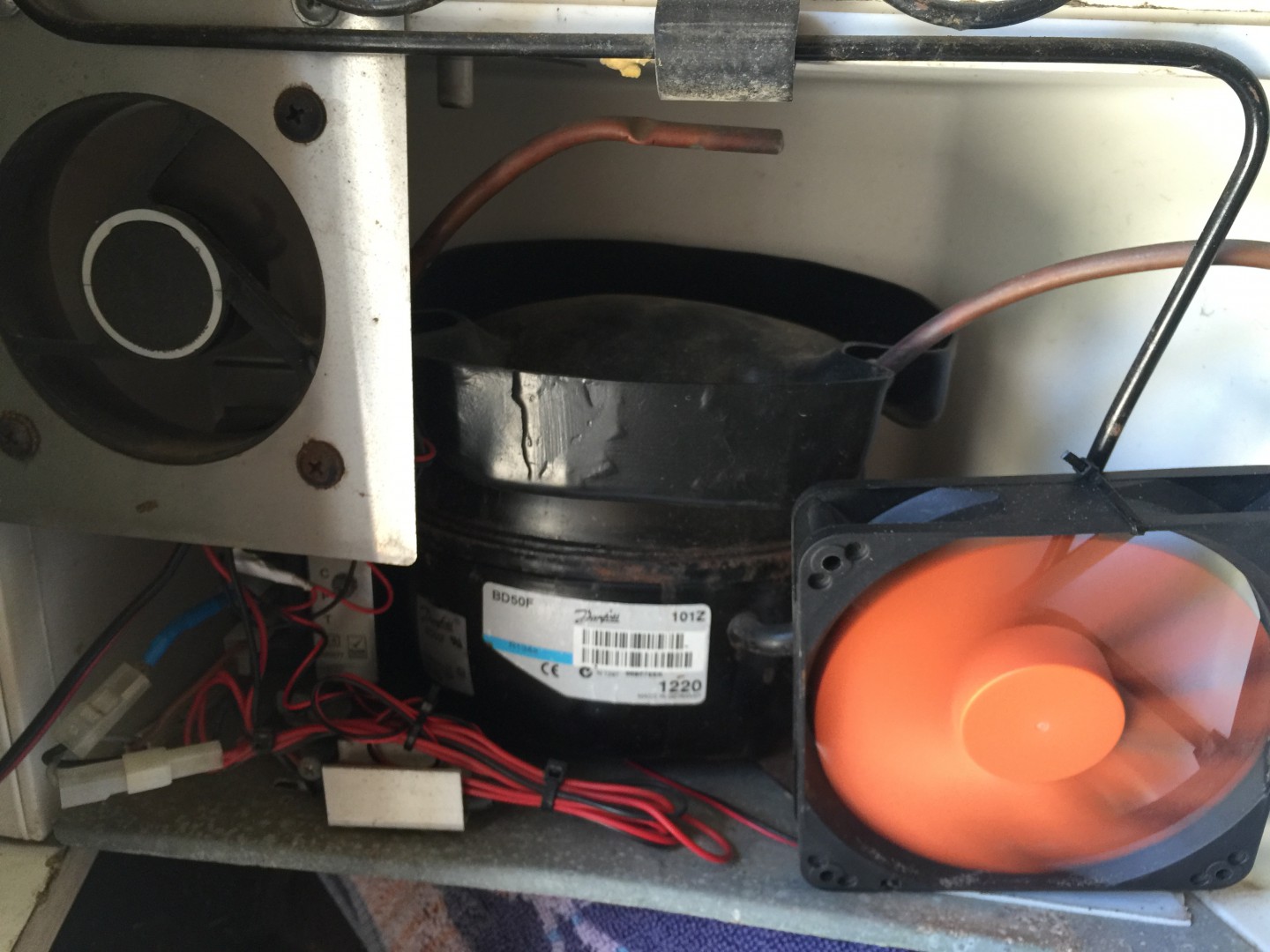

Any thoughts why my fridge wouldn't be getting too cold, it's a coolmatic HDC-160 the freezer compartment gets freezing but the fridge itself isn't very cold. I've checked the seals and cleaned the element thing on the back, also I fitted an extra fan next to the compressor to move a little more airflow but still no joy.. The model is a 2007 model... I've also checked the voltage and it all seems fine..

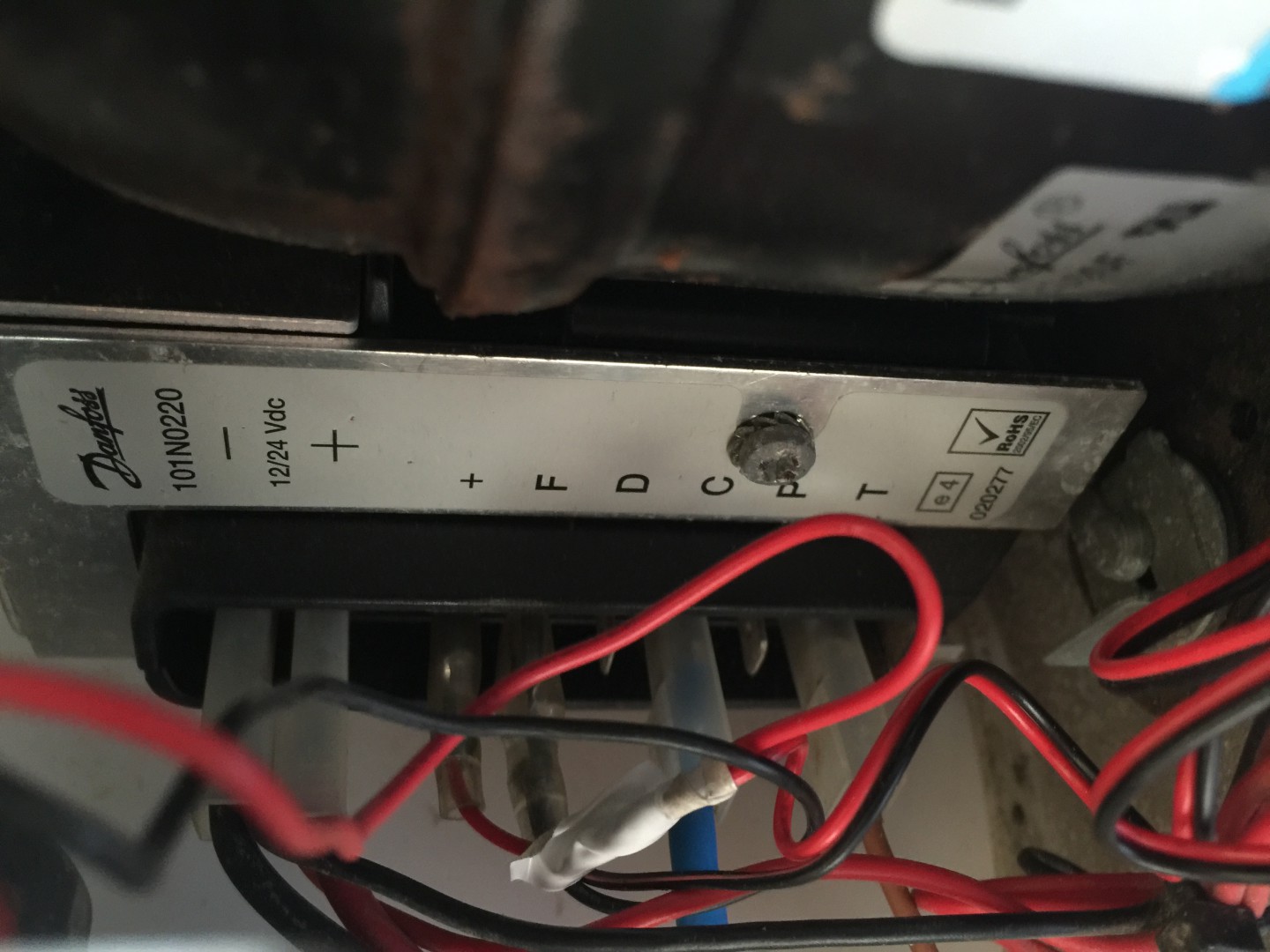

If I unplug the thermostat the motor turns off so I'm guessing it's working but if the motor did keep running wouldn't the fridge just get too cold?? I can't figure out exactly how it works..

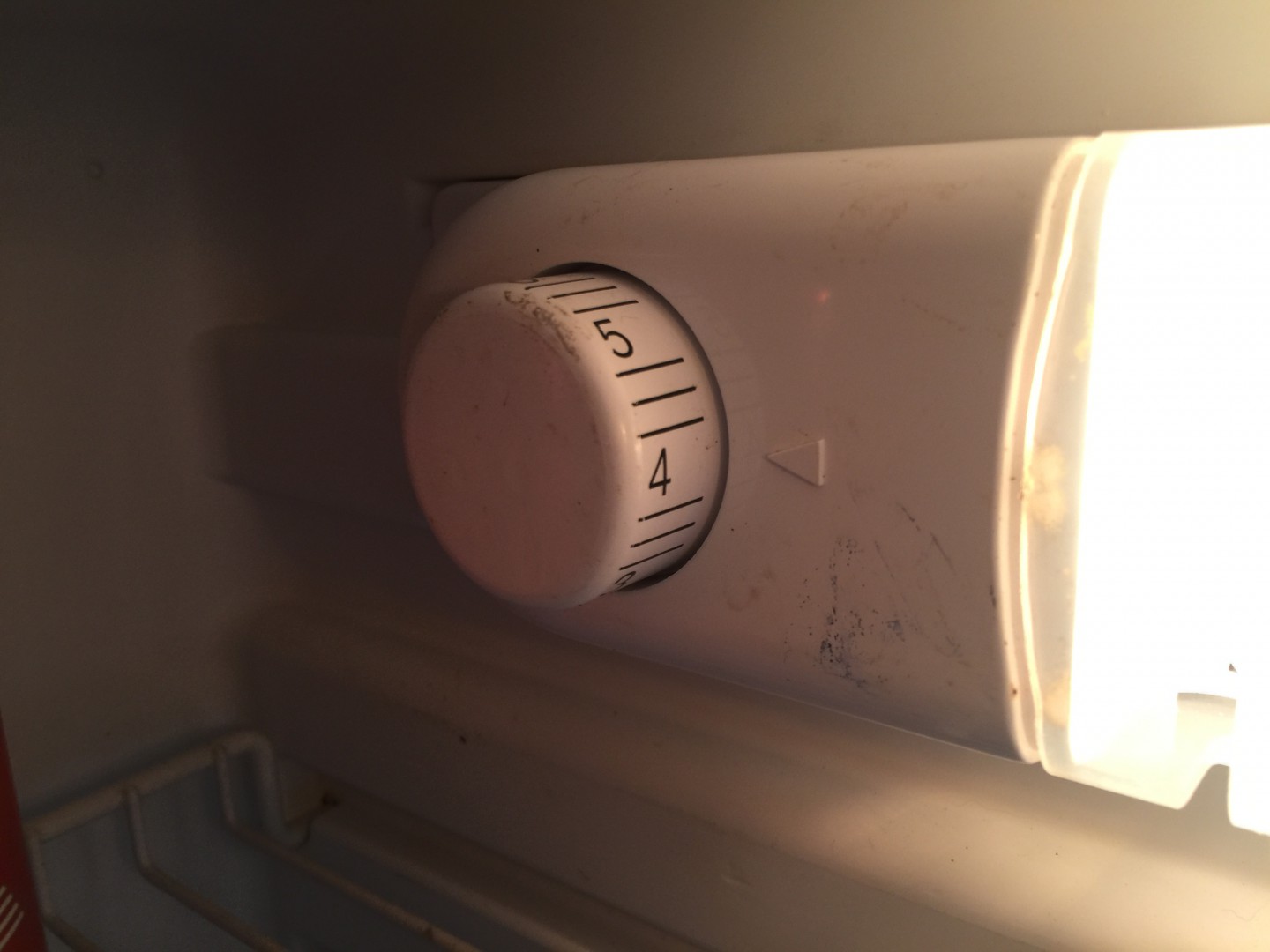

what setting out of what do you have the thermostat set to? 3/10, 5/10, 3/5?
The thermostat you have may be allowing the compressor to cut out too early to get the fridge really cold.

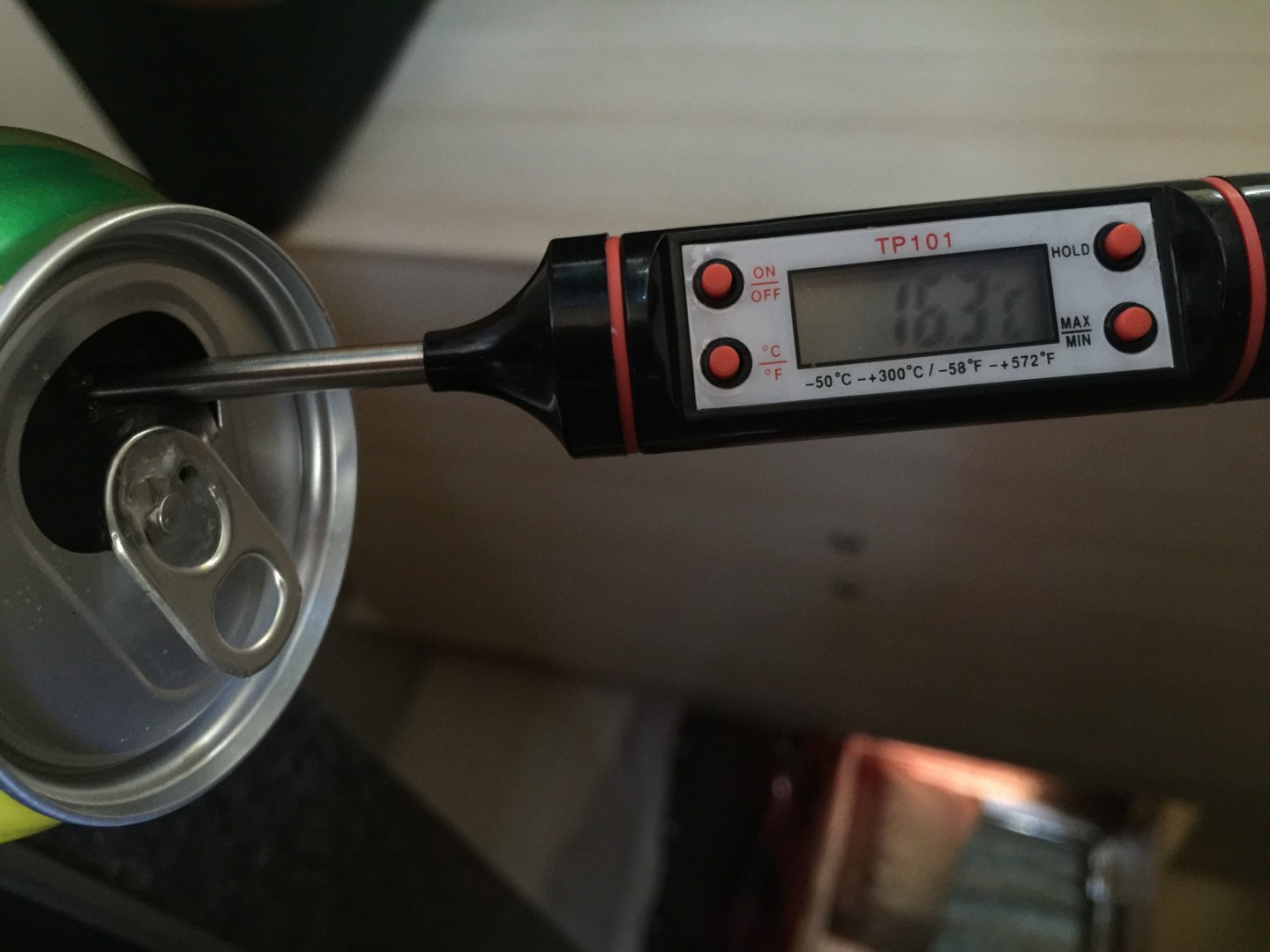

The fridge temp is 14-16 and the freezer temp is -20.. It's set to 4/7
This can has been in there overnight and still only 16deg.. Not sure which part of the fridge should get cold but most of it is just cool but definitely not cold anywher..
You will need to bypass the thermostat with a bit of wire and 2 clips and compressor will continue to run. If it gets colder then the compressor unit is OK. Alternatively give thermostat a bit of a tap when fridge has stopped running and see if it starts again.

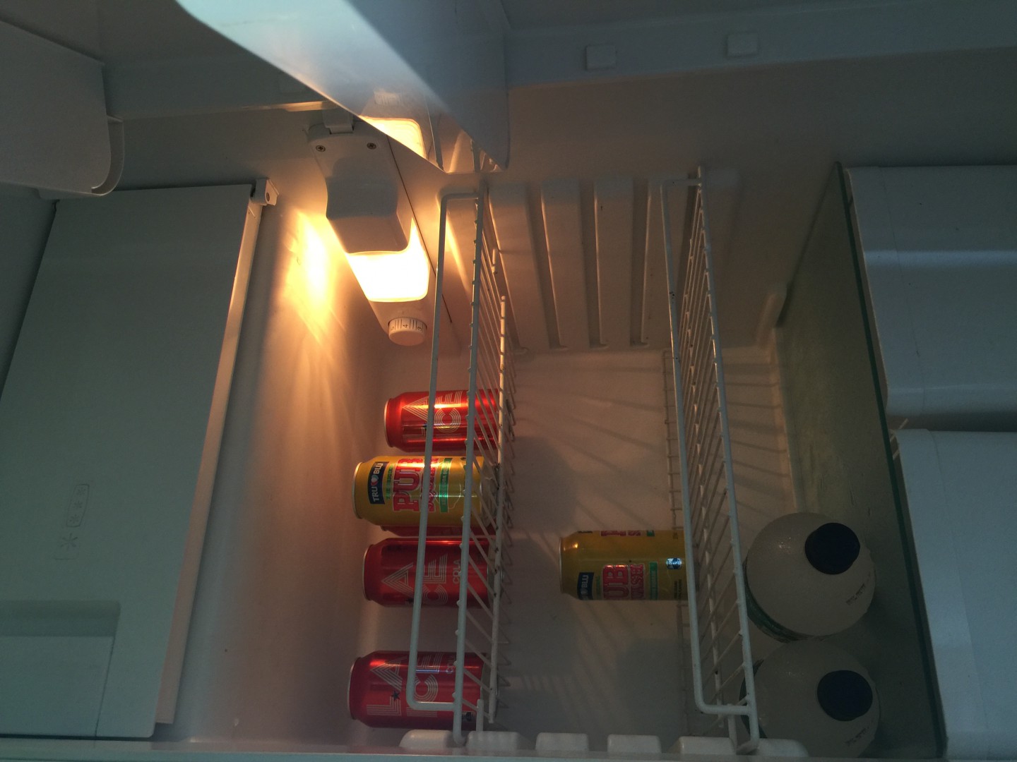

The cans you have in the fridge are in the warmest part of the fridge, according to the manual the coldest area is on the bottom shelf.
There seems to be no vent gap between the freezer and the fridge cabinet. I would expect that there needs to be some way for cold air to get into the fridge area.

I would suspect it has a small gas leak somewhere & low in Gas. The refrigerant flow is through the freezer first then down to the fridge compartment. First sign of low refrigerant is continuously running compressor, Freezer very cold & fridge compartment not cooling.

2 things come to mind. Is there a small fan between the freezer and fridge compartment that may have failed as that would explain a frozen freezer and not so cold fridge. The other thing is ice builds up around the freezer where the air is sucked into the fridge which will result in warmer fridge temps. hope this helps.
