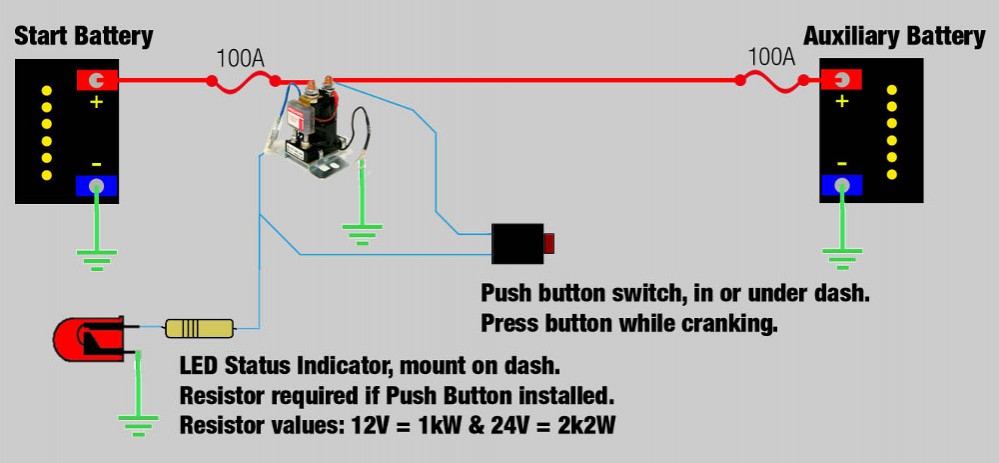

Spydermann, fit a VSR close to your main battery, similar to this pic from Redarc:
But instead of connecting the NEG terminals to ground, use 6B&S (13.5mm˛) twin to connect the batteries, and connect the red as shown and connect the black wire to the NEG battery terminals at each end. If you want to use the jump start function, you'll have to use heavier cable such as 2B&S (32.5mm˛) and connect the push button momentary switch as shown. The LED and resistor aren't required to use this function, they serve as an indicator in the cab. Where the fuses are, use 60A manual reset Circuit Breakers (100A minimum if using the jump start function).
If you have a variable voltage alternator, you would be better off using a DC-DC charger instead.
