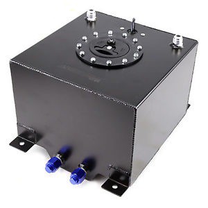

Has anyone experienced any problems with the fuel tank in the picture? ie: light weight construction, leaks, poor seal on cap. Your feedback greatly appreciated.
Peter_n_Margaret said
06:33 PM Oct 18, 2015
I would avoid steel tanks due to corrosion.
Try this guy in Turkey. He has free delivery to Australia and provides excellent service.. dieselheaters4u.com/index.html He has a UK Ebay shop.
(We met him in Turkey when we visited in 2013).

Thanks for the suggestion, have thought of using one, but have insufficient room to install one.
09:13 PM Oct 18, 2015
My old motorhome had tank Mounted under floor with filler ..

Thanks again Guru, will keep in mind & have a look at what space I have under the caravan.

I have one of these tanks fitted in the front boot of our van and cannot fault it, I mounted it upright and can fill it from a bowser if needed, but mostly fill from a 5 litre can.
10:48 PM Oct 20, 2015
Check here for fuel cells .. You don't require the foam filled ... http://www.ebay.com.au/sch/i.html?_odkw=solar+fan&_osacat=0&_from=R40&_trksid=p2045573.m570.l1313.TR11.TRC1.A0.H0.Xfuel+cell.TRS0&_nkw=fuel+cell&_sacat=0

Thanks snapper I will give this one some serious thought.
vanman said
10:47 AM Oct 24, 2015
I bought a 5lt. yellow diesel fuel tank from Supercheap cost $19.50 a small battery box of eBay cost $17.50 and mounted the tank etc. in the front boot. Total cost $37.00 plus some small hose clips.
I modified the filler which comes with the container.
Chris
elliemike said
01:53 PM Oct 28, 2015
This is the one supplied with my Dometic Diesel heater (Eberpacher) 10 ltr Diesel tank.
09:22 AM Oct 29, 2015
The Webasto and Eberpacher heaters are generally listed in catalogues without diesel tanks. That is because they have the option to be used from a small tank or for motorhomes they have the option of a 'T' piece to hook into the trucks fuel line or a take-off from the main tank. The tank that Mike pictured is the one that most fitters use if a separate tank is installed. Some suppliers may however offer a heater plus tank kit price.
