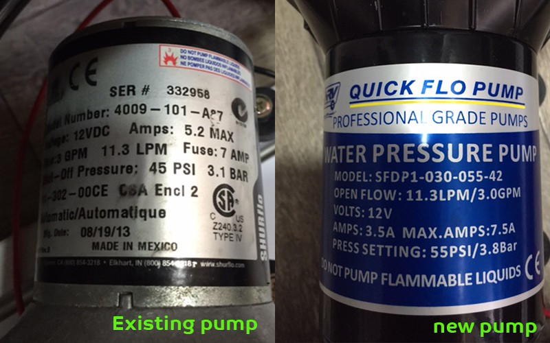

I am fitting a new water pump into my van. The old one is still working but is very noisy. I have purchased a new pump that when tested outside of the van using a bucket of water does appear to run quieter once the initial priming has finished.
Here is my problem. When I replace the old pump with the new pump the water pressure is far less then the old existing one even though is is rated higher.
Old pump is a Shurflo - 45PSI and 3.1Bar
New Pump is Quick Flo Profession Grade Pump 55PSI and 3.8Bar

I have discovered what the problem was (just 5 mins ago).
The problem was in the fitting to the pump from the water tank. Even though it had the same thread it was not tightening sufficiently and therefor the pressue was being lost. Once I attended to this all is now well.
