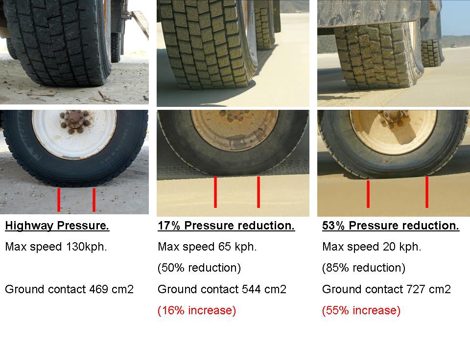

Many caravan travellers could be hammering their vans into an early grave and costing themselves thousands of dollars in repairs and lost resale value by not lowering tyre pressures when they leave the bitumen.
They have it all wrong, in my view.
The primary purposes of reducing tyre pressures on rough or soft roads is to improve flotation and to protect the tyres from damage.
It is the suspension's job to 'take care' of the van and there in lies the main problem in that many/most vans have disgusting suspension.
Lowering tyre pressures will help the van survival a little, but it is really a bandaid.
This is Michelin data for the tyres I use on the OKA.
A 50% reduction in highway pressure is quite dramatic and bust be accompanied by a serious reduction in maximum speed (in our case it wequires a MAXIMUM speed of 20kph. Exceeding that will overheat the sidewall and destroy the tyres.
Interesting how some statements get taken verbatim rather the understanding the intent of the advice.
Yes, it is the suspension's job to "take care" of the van ... springs to allow the 'shock' to be 'absorbed' and the dampers (shock absorbers as we call them here) to keep the springs' movement controlled.
However, a tyre pumped to 55psi is going to be much 'harder' and far less flexible than a tyre at 25psi - 'road shocks' will be transmitted directly to the suspension. These pressures are very sensible for driving on sealed roads at 80-100kph.
However, if driving on unsealed (rough) roads that pressure will be FORCING the suspension to "do its job". This will cause the springs to be forced to flex considerably, and constantly, and the damper (shocker absorber) to be subjected to considerable up and down motion ultimately overheating the oil and losing its ability to dampen the 'road shock' and FORCING the suspension to NOT be able to 'do its job' ... transmitting the road shocks directly into the van's frame and internals.
Conversely, a tyre at 25-30psi, with the additional wall flexibility, will - in itself - absorb a considerable amount of the road shock BEFORE it is transmitted to the suspension - allowing the springs and dampers (shock absorbers) to work less arduously and continue to 'do its job' for a considerably longer time.
HOWEVER, IT MUST BE REALISED THAT IF TYRE PRESSURES ARE REDUCED TO THESE PRESSURES THEN THE SPEED OF THE VEHICLE/VAN MUST BE MUCH SLOWER.
As stated in the article, if running 25-30psi then road speed should be 65-70kpnh so that the tyre walls, which will now flex more, are not subjected to overheating. Personally I would travel closer to 50-55kph.
This advice to lower tyre pressures AND SPEED for unsealed (rough) roads applies equally to the vehicle as much as it does to the van.

Big thing to consider is speed to tyre pressure V weight .. Lower pressures does help tyre, suspension harmonics over bumps ..
Just be aware some green horn from the city dropping pressures by half in hid twin turbo Lexus 4WD .. Lol . Then driving at speed .. It's ok I saw it on the Internet..
