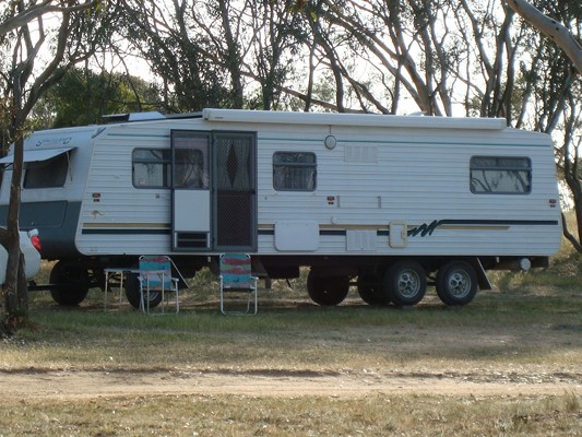

That's a worry. A bit out of alignment when braking and it will easily push him sideways.
KFT said
09:11 PM Oct 5, 2015
Nil ball weight
wonder how well it tracks
JC is the steering geometric or simple like a horse drawn wagon?
WobblyNut said
09:45 PM Oct 5, 2015
I have a "farm trailer" like that . "dog trailer configuration"
I Would rather Tow like that than a towball & I used to with my
mobile home , used one as an "a frame" on my surf
Woody n Sue said
09:54 PM Oct 5, 2015
For those who struggle to back a normal van wouldn't have a snowflakes chance in ( u know where ) of backing this van up not to mention swaying behind you on the road
Cupie said
07:54 AM Oct 6, 2015
I assume that the 'A Frame" comes directly off the front axle group.
Is that correct?
Ondabeach said
09:52 AM Oct 6, 2015
JC, I hope that all up weight of 3.75t includes the Triton
With that front axle on the van, swaying wouldn't be a problem, the 2 main advantages would be towing stability and very little ball weight. With the pivoting front axle and the rear axles set so far back it'd be a lot easier to back than a conventional van. The rear axles of the van are it's pivot point, and being set so far back it would be much less sensitive to steering input when reversing.
-- Edited by Ondabeach on Tuesday 6th of October 2015 10:00:23 AM
-- Edited by Ondabeach on Tuesday 6th of October 2015 10:00:47 AM
-- Edited by Ondabeach on Tuesday 6th of October 2015 10:01:25 AM
justcruisin01 said
10:44 AM Oct 6, 2015
Ok, some interesting theories going on here but sorry, no cigar as they are all wrong.
I'll try to make this as simple as possible; the front axle is a rigid axle same as the rear's, so there is no a-frame for the towing.
It is a single pole from the tow ball to the centre of the axle mounted by a piviot point.
Steering; on this single tow pole about 200-300 mm ( estimate) from the axle end there is an attachment on the R/H side where a drag link is attached & connects to the R/H wheel like the drag link on a 4x4 or truck.
The two front wheels are connected behind the solid axle with a tie rod link; ( again same as a truck,4x4), adjustable for alignment.
As the tow pole moves from left to right it steers the front wheels same as a steering wheel does.
All six wheels are braked via an over ride system.
Reversing; reasonable difficult but possible over a short distance.
This guy is dutch, drove articulated vehicles ; that licence has been cancelled due to open heart surgery as he is in his late 80's. Lives in Vic.
He designed & built the chassis him self about 18yrs back, had the van built on it by Spaceland vans.
He is the sole owner & its always been registered so no inspections required, maybe a different matter these days if a change was to come about.
Never been pulled over & checked; but did say that the cops in Shepparton were looking hard at him when he came through but no being stopped; maybe it would be to hard for them.
The weight I stated is van only, no ball weight at all & towed by a Triton, beats me.
So there you have it; maybe clear as mud to some but thats the way it is.
JC.

Ok, same difference then, the front wheels steer, so that's all good. BIG problem with the weight though... the braked towing capacity of a dual cab 2WD Triton is only 3000kg and 4WD is 3100kg, so highly illegal, not to mention dangerous

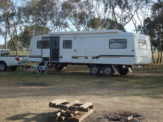

there was a photo of this posted some time back but here it is again & this time I had a chance to view the arrangement externally
Comes in at 29ft & 3.75 T.
JC.
What is towing it JC???
A triton dual cab.
Is that correct?
JC.
