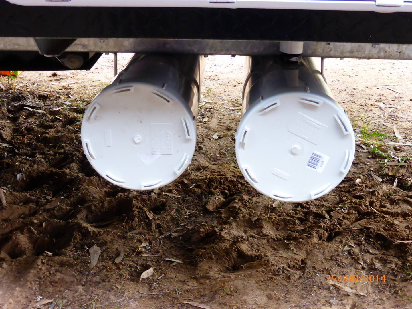

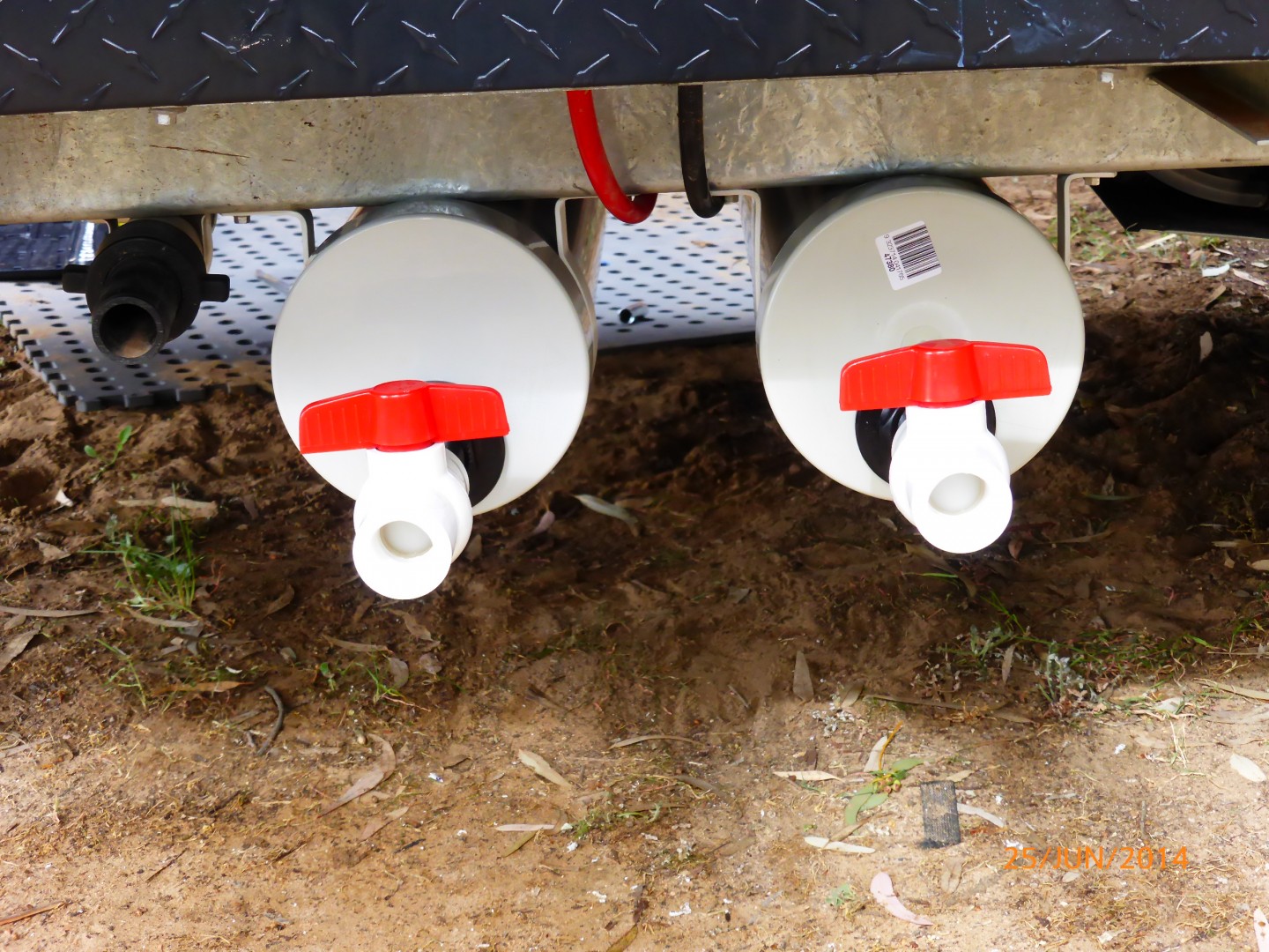

I have watched and been amused with this post that is now 700 + hits and about 21 replies. The need for S traps/non return valves and the numbers thrown up for holding capacities are from people who have no idea. I can recall a post from some one who made the quote " if you have an option on your van or accessory those with these options accept it for what it is and the benefits. Those that don't like to make an argument in the negative".
I have attached pics of the original set up and will provide details below. The system has been in place for 18 months without any issues. We are full time "on the road". however we do house sitting so the van will sit for periods of a month or so. In this instance the caps are removed to air the system.
You require 2 x 150ml x 185 lengths of sewerage pipe.
Plus caps/plus taps/plus plumbing software.
The calculation is 32 litres per pipe in total 64litres. (You need to do the maths) which confirms??????
The back pipe is for the shower only and does NOT connect to the front pipe.
The front pipe collects the sink water at one point and the vanity at another point
When emptying we use clear plastic hosing that is attached to the taps and enters our grey water hose.
These is a rarity as most times we either enter direct to a dump point or at a location suitable for dropping grey water.
The $$$$$ savings, the ability to be self contained and the need to leave "no trace" makes our system unique and unequal when looking at commercial sold grey water systems.
