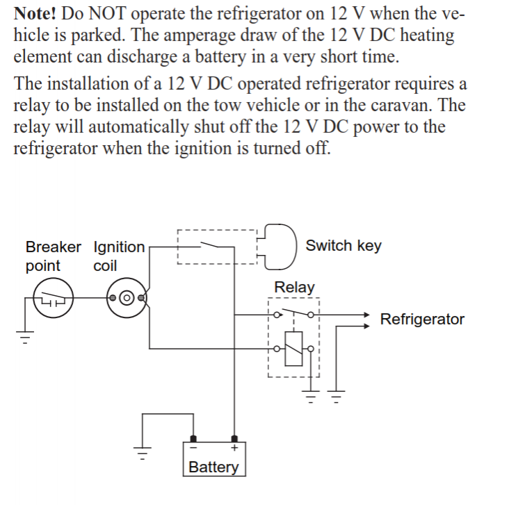

Secondly, when travelling do I leave the fridge mode on 12V and will if so will this drain the battery.

To your second question, providing you have adequate wiring from your car's battery to the van fridge, preferably via an andersen plug at the towbar, AND providing your car's alternator is working then the car battery will not be drained.
It is not advisable to run the fridge from your van's battery.

Dave H wrote:Secondly, when travelling do I leave the fridge mode on 12V and will if so will this drain the battery.
As stated by the previous answer, the 12 V element in a 3 way fridge should only be run from the tugs alternator. This is the way that Dometic say it should be connected up to the tugs electrical circuit.
