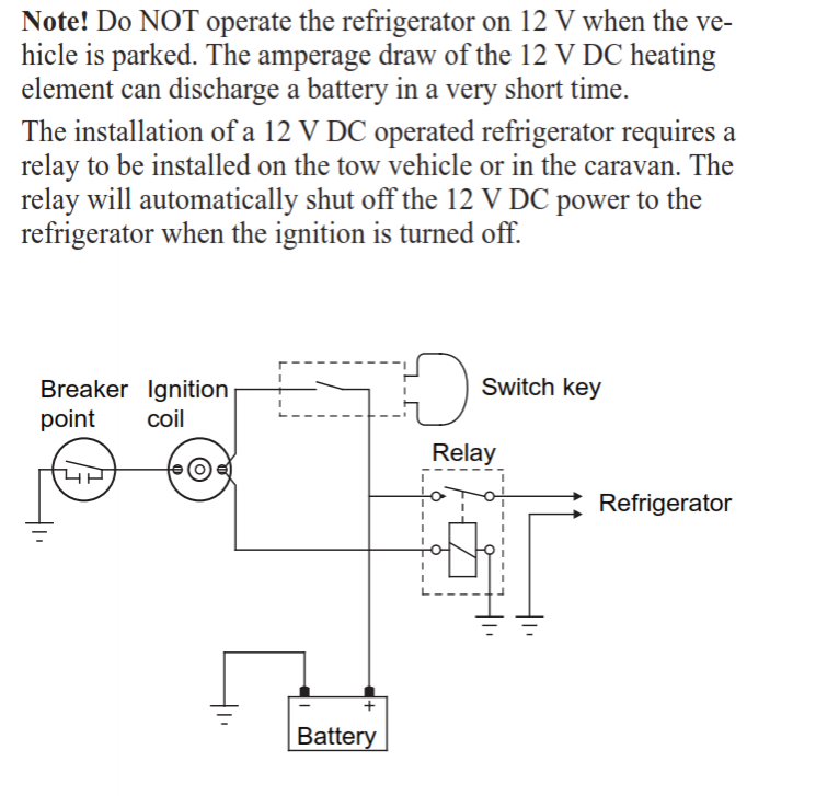

Got thinking about the power draw of our 90L 3 way Dometic fridge in the van and thought when we stop for a length of time (sight see etc) it could drain the battery.
Our setup is probably like most, 6B&S twin wire from car battery to Anderson plug at rear then connect from here to the van. This wiring runs the fridge in the van only.
400watts of solar panels on the vans roof charge the van batteries while the sun shines driving or stationary.
So I decided to add a precautionary item in the way of a relay into the wiring circuit that is live while the ignition is on and when off nothing is live.
As the fridge draws around 15amps it has the potential to drain a battery if left unchecked for a period of time I would imagine.
Didn't want to use a switch as I have a tendancy to forget things so made it Vince proof this way
Will see if this idea is workable after some road tests.

Yes Lance I had a look at that idea and decided that putting a relay and a dash light connected for function - IE on / off
I can also see if power is getting thru while ignition is on if not look for a blown fuse or other problem.

Your ignition operated relay is a very common way to do it, and works well.
This is the way that Dometic recommend that you wire up your tug.

Currently the Fridge Switch coats $66 . Why not user the protection that Dometic specify? An ignition switched relay costs less than $10 and the installation costs are around the same. An added advantage is if you are getting an auto elec to install it you don't have to drag your van around to him.
