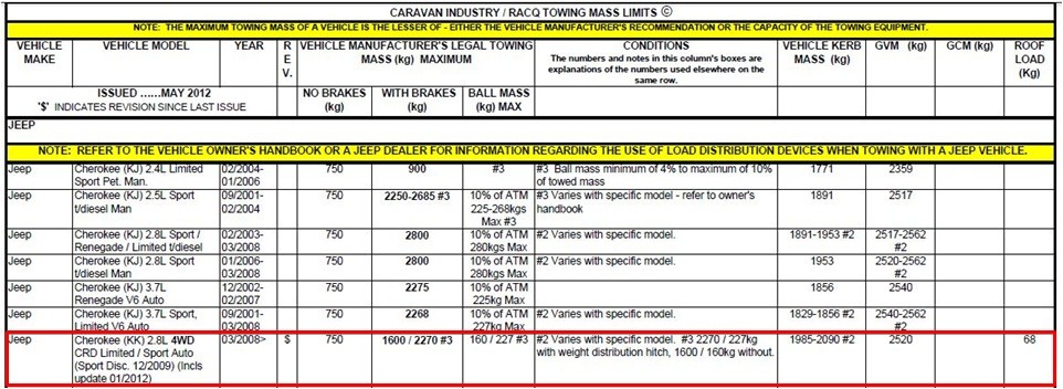

Mike, I suggest you refer to the Owner's Manual that should be with the vehicle. It should detail the limitations/specifications for towing.
In the meantime, this will give some information -
I draw your attention to note #3 in the Condition column.
