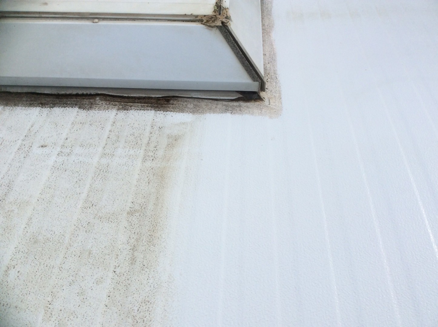

Have you a dirty roof on your van,my van is not under cover and keeps getting crap on the roof from the trees where I park it,if you are in the same situation here is how I bought it back to new looking,I dampened the roof with water and sprinkled Ajax Powder on it and with a little bit of elbow grease it came up like new.
Ajax might be a rad rough on the paintwork though olley, or to you have a ruberised membrane coating?
madaboutled said
08:35 AM Oct 28, 2015
Another trick for when the roof is clean to help keeping it that way is to spray the roof with a clear silicone spray, nothing will stick to it thus helps makes cleaning a breeze, in most cases just a medium to high pressure hose off is all that's needed.

I do mine with the water blaster a couple of times a year and it comes up gleaming.
just need to be careful near any sealant joins though.

Yeah, i'm thinking Ajax might be a bit too abrasive, unless it's different to the old ajax.
Olley46 said
10:48 PM Nov 3, 2015
The roof still has a gloss finish looks like new.

We have only washed in car wash solution with a little Kerro in last wash.. With rubber roof I intend to either add some rubber paint to protect another 10-15 years ? And or make a solution of bees wax and turpentine as a water replant solution.. Have used it on concrete in dairy and nothing sticks to concrete in 15 years .. My issue with silicon .. It's a pita if you ever need to point your vehicle .. It just doesn't wipe off ..
