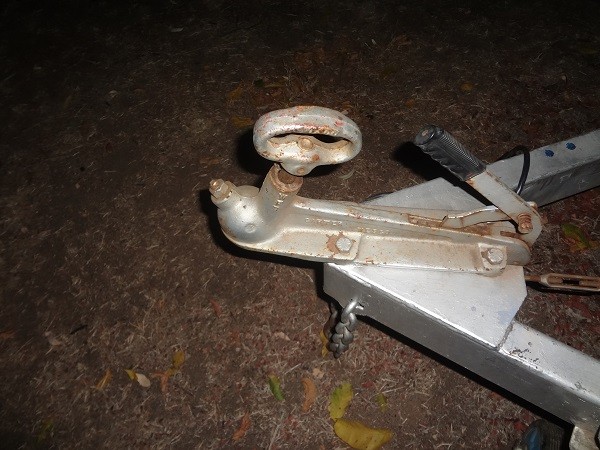

Next small problem is your tow bar, now that needs sorting is it rated better then you need or there abouts, I doubt wherter you will need a heavy duty towing pack. If your tow bar is a square retriever style there a good chance that will do but if it's a flat style off to the wreckers to find a second hand heavier style tow bar to save some money. The major issue here is the flat style will only allow about 750kgs but the square retrieval style will allow lots more and you will need about 140 kgs on your tow ball.

towbar is standard flat tongue so you are suggesting that i might need to look at a box type hitch ? don't know how else to describe it

A great photo, like Bill I would think it has electric brakes, maybe look underneath behind the brake drum and see if there is a power cable there, the cable will most likely run from the chassis down to the backing plate of the brakes hopefully the answer will be yes in which case the next step will be to obtain a brake controller and have it fitted to your car. A basic one would be good enough to do the job on this size van.
Now the question of the tow bar what you said a flat tongued type now that maybe under rated as I am not sure but from my own experience of towing some engineer has slapped 750kgs tow ball weight on them.
The age of the car and being a Ford there would be one or two laying around in car parts recyclers or wrecking yards.

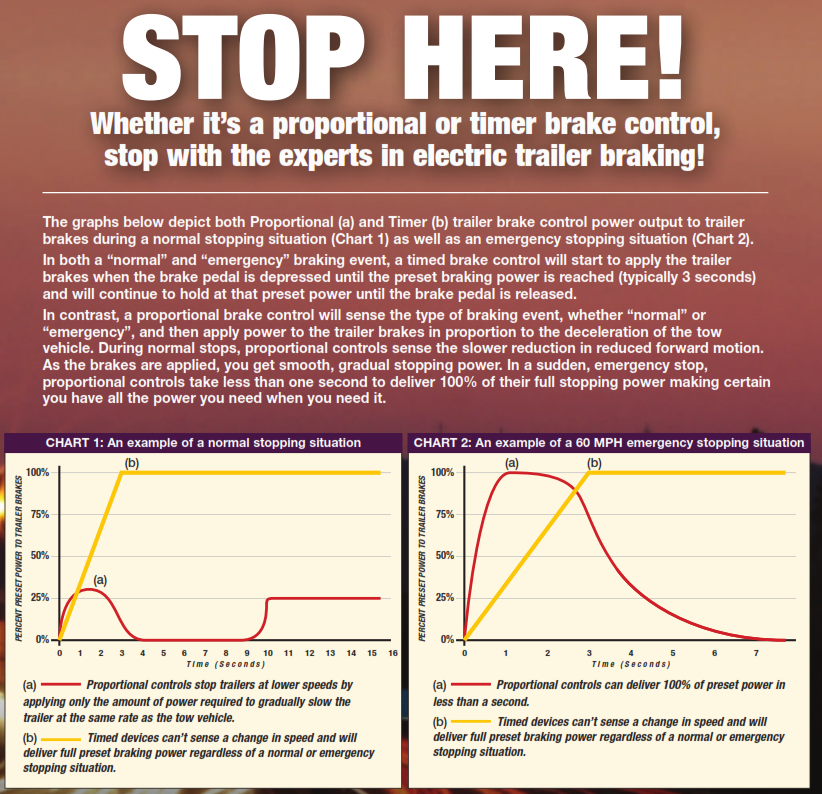

Here are the pin connections of all the trailer plugs. Go to this link. I would not rely upon the colour of the wires (in other words ignore the emphatically expressed blue wire.) A van of the age of yours could have any coloured wires.
The first thing you should do is to go to a weigh bridge with the van empty (including the water tank.) Weigh the van still attached to the tug. Then weigh the van with both the main and jockey wheels on the bridge. The difference will be the approximate ball weight (accuracy will be in the range +/_ 30 kg if the bridge only reads out to the nearest 20 kg.) If you can find a caravan yard with a ball weighing scale that will be more accurate, ask them to weigh the ball weight for you. Report back when you have the weights, we will be able to offer better advice then.
I would advise against a basic (or timer or synchroniser) type brake controller. They do not act like over-ride brakes. Over-ride brakes have a proportional action, the harder you brake the harder they work. Here is an explanation of the difference in controllers:
I would advise against a basic (or timer or synchroniser) type brake controller. They do not act like over-ride brakes. Over-ride brakes have a proportional action, the harder you brake the harder they work. Here is an explanation of the difference in controlled.
Hi PeterD
At present in our Late model Nissan Navara tare 2100kg & singl axle caravan grossing 1900kg we are using the older basic style brake controller with confidence in this set up with weight of the tow vehicle heavier then the towed trailer. If we replace this van with a say 3000kg van we will then look for the best option.
I would think travelling at or below 90ks in emergency situation there would be little differences but I am not qualified to debate this, only experienced by my training as a transport driver operating mainly semi trailers, one thing we did learn was to drive to the conditions and enjoy the drive.
I thank you for putting up that graph to show the differences and it may help other readers in there decisions when purchasing a brake controller.
Thank you. Ralph.

Good that answers that question, now for a brake controller, somewhere between $80 to $150 plus fitting.
As to fitting it, up to you, to some it simple, the hardest part for me was getting the wires though the dash and firewall. Very rewarding when you do small jobs on your recreation vehicles almost as good as using them.
There is basicly 2 types the choice is yours, PeterD put up graph with a link on the webb to go to, have a read, very helpfull.
Next is the tow bar and it want be long, a few dollars shorter but there will be a time when you will enjoy your Caravan safely.

Hi David
Thank you. Ralph.
