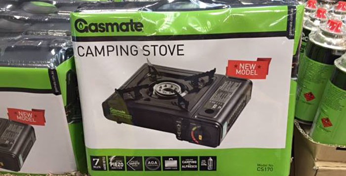

I have bought one of the new stoves from bunnings From my observations the differences are The plate the pot or whatever sits on is now fixed in position (my non approved one wasn't ) The pot now sits slightly higher over the flame There is now a baffle plate between the burner and the gas cylinder (my old one didn't have) There is supposed to be a better shut off system (no way of knowing)
They are $29.90 available from Bunnings I bought mine in Canberra
The older gas cylinders do work in the new stove

Just bought one for $34. Apparently they've been upgraded and now don't pose a problem anymore.
It sure would be nice if someone would take a photo of the up-grade, Just to show others what the difference is between the old stove and the new one,
I have emailed different manufactures of these lunch-box cookers and asked them to show me the improvement, so far not one has replied,
makes me wonder if the only improvement is the new safety canister,
Which is supposed to self vent if it becomes over heated, my next question is, what happens to the gas when it self vents, ????
I always thought that gas was explosive, here we are told that the canister is self venting, but still safe to use !!!!
Makes me wonder, who is fooling who ????
K.J.
