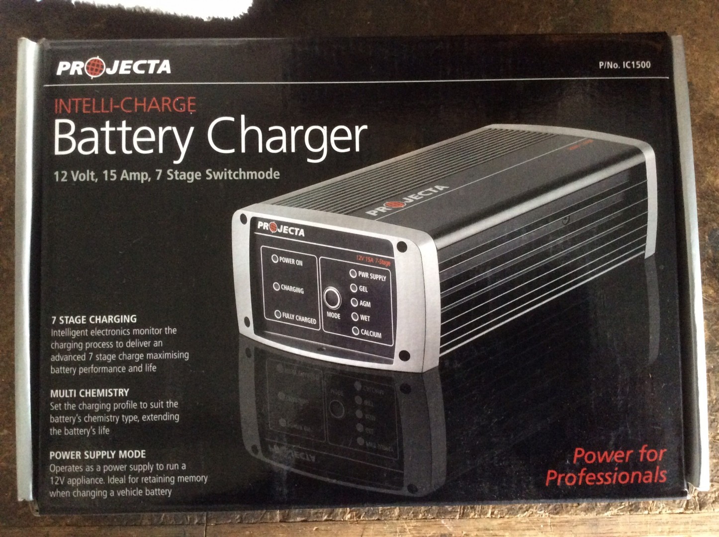

I have a Projecta 7 stage charger in the coaster ,connected permenantly so soon as I plug into 240 volts ,it's on .it's has a remote panel that I have mounted just above the drivers seat that tells me the battery condition whilst driving.

This is the one I use,soon as 240 volt is turned on it is in action.
I use Projecta at work, and have a small Ctek at home. My choice would be the 25 Amp Projecta. The reason I recommend this one is that there is more info on the front panel of what's going on, also you can get a remote heat to mount else where so you can see its status. It also has over heat protection and will shut down if the thermocouple connected to the battery gets too warm. As with anything you get what you pay for.
One other point, these new chargers don't like charging ( or won't charge) a dead flat battery. A dead flat battery will need to have a kick start from the old style "pump power in" type. So i/2 hour on the old type battery charger then switch over to the new charger. So keep that old charger just in case.

I don't know what is the "best" one but this is what I use. Works fine, not too expensive & lightweight.
