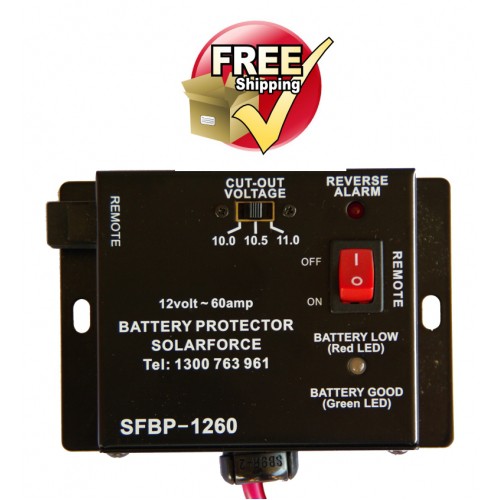

Thanks for your comments. The battery protection unit (Solar Force) that Retreat put in has not got any settings that I can see to alter the cut out voltage. It cuts out at 10.20v, but the batteries still show 80%. I have been testing it at home without using the sleep apnea machine, and it still cuts out at the same voltage etc. When we are camping, and the battery protector cuts the power, we can turn off the compressor fridge (Waeco 215ltr) and we can turn the lights on again.

Harry, if it's this particular one, it does have an adjustable cut out voltage, but it's still too low at a maximimum of 11.0 VDC. 12.0 to 12.2 VDC would be a better level.

The battery protection unit is similar, but not the same - does not have the cut out voltage bit. I think that the voltage drop should be much higher than what it is, given that I get up to 13.33 during the day.
