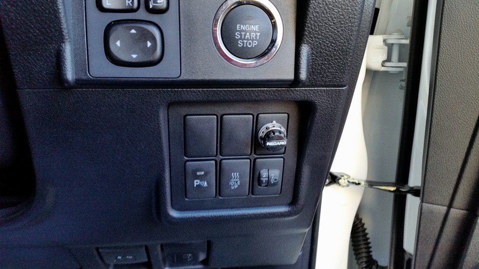

03_Troopy said
05:37 PM Sep 17, 2015
I take it you're referring to the Redarc Tow Pro? Here's a pic of one fitted in a Prado. If yours has the same size hole for the start button then it should be OK there.
Yes should be same as. Mine has a Toyota plug that should just pop out.
thanks for the pictures.
Jim
