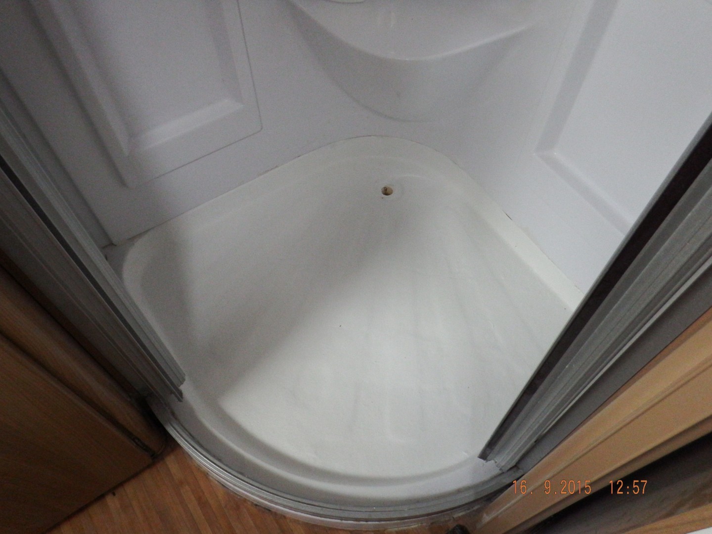

This may be as interesting as watching the grass grow, however I need to let Jayco owners know there is an answer to the cracks in the shower floor.
As reported before we were getting large cracks in the floor. Jayco had no answer so I bit the bullet and put down some fiberglass patches.
All well and good for a time, however the bits outside the patches started cracking. BUGGA!!!!
I went to a Murray Bridge composites mob, after explaining the situation I picked up some 400GSM mat (fiberglass) resin, and a can of white flow coat (as suggested on this forum)
Long story short. I put a full cover of glass down, 2 coats of flow coat and bingo works like a charm.
Hi all
One happy camper
Hi Phil,
Looks like a good job from the photo. BUT however, You forgot to clean the drain hole with your tooth brush.

Thank goodness for that Phil. After all these months of no shower It was starting to sm.....nah, saying no more mate.
Nice one Phil
Good result Phil, well done.

Just an update on the dreaded shower. The floor is as solid as rock and hasn't even hinted that it will crack again. Woooo hooooo
No more Shiraz showers.
should outlast the rest of the van mate!!
