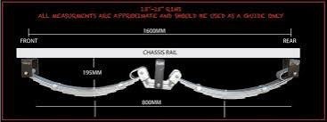

Wondering if I have more hassles here - looks like the bushes on the front leaf springs have perished. I noticed this when emptying the water tanks last weekend in readiness for the Seabird Get together. Still havn't used the van yet

Hi Peter,
The bush in the rocker arm will be stuffed too.
I replace ALL of mine before each trip to the west on our tandem boat trailer. Ours are only a hardened form of condute and wear our very quickly 12,000km.
If I could buy Brass or S/S I would.
Regards Jim

Get some eurethane bushes from a suspension repairer , fairly easy to change ,and will last a lot longer.

12:20 AM Sep 17, 2015
Can't see whole assembly ? Is there supposed to be a gap ( slider) to allow for spring length when it compresses ?

note the larger slider eye ?
