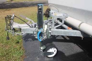

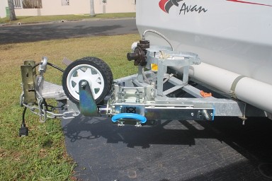

However, in the 3 years we've had the van I have never been happy with the small 6" jockey provided by Avan - in around 20-30% of sites it tended to dig into the grass or sandy site base. As the new power movers create a fair amount of 'shove' in moving the van, I decided that the old jockey had to go. I fitted one of the new ARK heavy duty off-road units - twin 8" wheels with sealed ball bearings, 90 degree trailing yoke, 4 mounting heights with a full 250mm height windup, side wind type with removable handle, and can take 750kg down-force - a really HEAVY DUTY unit - although it could be considered major over-kill for the Aliner, it just breezes across grassy ground - doesn't dig in anymore. It was worth the extra cost - it will do us until we reach the age and health were we have to stop vanning altogether.
