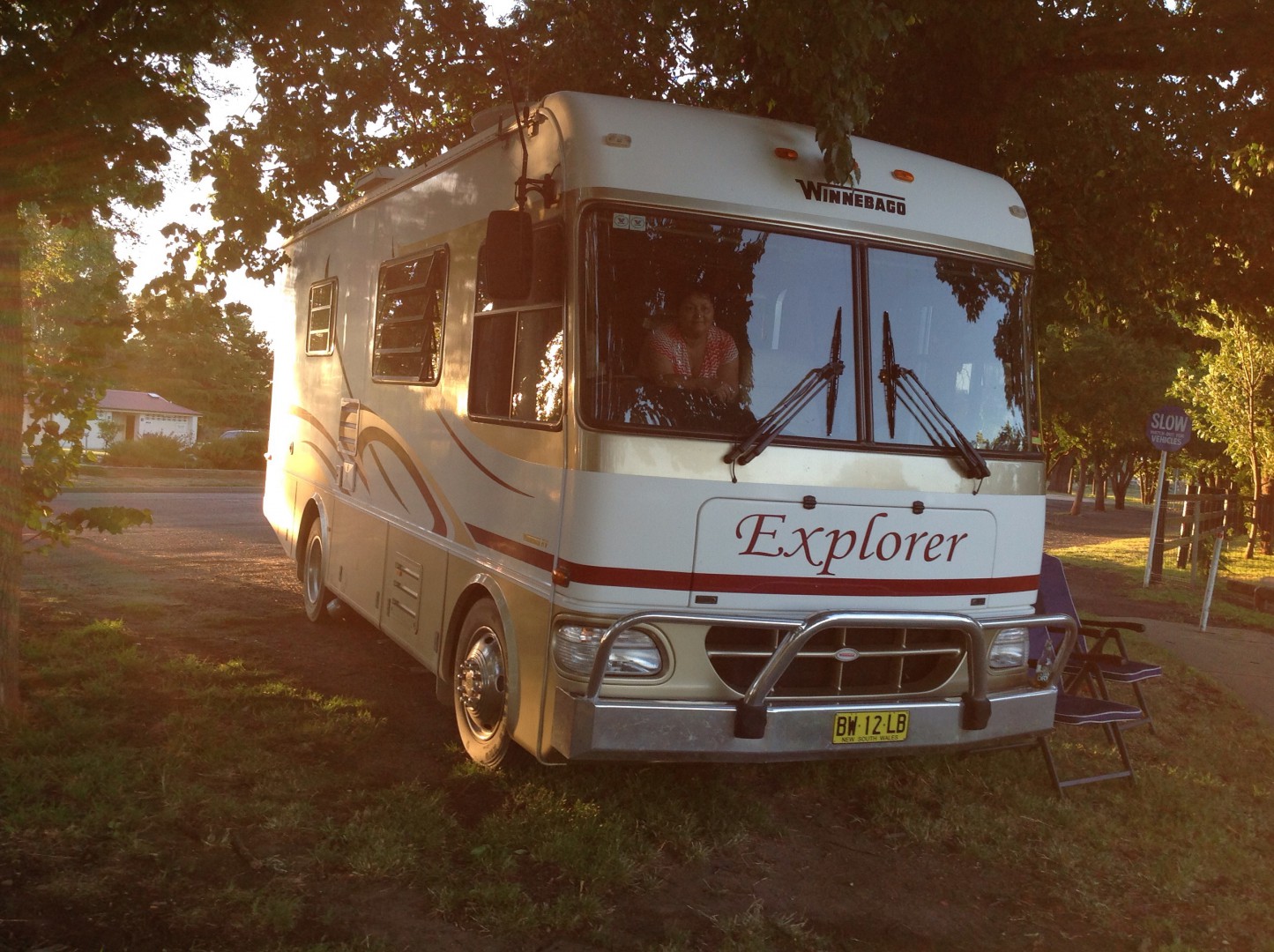

Hi Aus-Kiwi
I am having similar thoughts about our EPDM roof on the old Winnie
Can you give exactly what the name of the products you used on your rubber roof & where did you purchase them from, Tried googling "Base Coat" but 100s of listing under that heading.
The "Base Coat" is the "Membrane" product I assume, can you tell me who is the manufacturer & where did you get it from please.
Did you then use what you call "BEST paint for application" what did they recommend , 3 coats to cover the membrane ? Wouldn't the paint then eventually crack as the EPDM rubber & I assume the "membrane Base Coat " is so flexible?
Has anybody used Thermo-shield on their EPDM rubber roof?
Quote from their brochure
"The THERMO-SHIELD Roof System can be applied directly to most clean, dry, sound substrates, including metal, concrete, wood, asphalt shingles, tile, asbestos, urethane foam, and EPDM."
Winabago Explorer motorhome .. Has anyone painted or done any maintenance on there roof..
Its mainly for maintenance .. Where did they buy the paint or covering ?
I see YouTube how it's done .. But they are mainly US sites ...
would like to do preventative maintenance than replace or have issues latter ..
