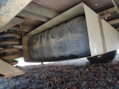

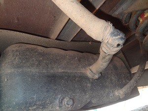

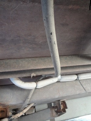

have tried the water tank and cant get anything out of it read all the past messages about them here but i can see a breather hose on mine there appears to be a pipe old plastic hose ( looks like garden hose , should i replace it van is 30 yrs old ) going to the pump tap ( works well took it apart and tested it in a bucket ) and the fill pipe to the tank ( see photos ) but no water again will come out pumped for about 15 min and nothing

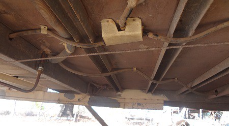

topped up tank but noticed water pouring out underneath appears to be from top of tank( tapping sounds and feels metal ) but cant see where water is coming from as is enclosed in a metal cover photo 4 shows the tank end where the water is coming out thought it was the seam between top and bottom to start with then noticed water was coming down the end of the tank
photos 1 is the filler and pipe to pump tap 2 ,3 show pipe running from tank to pump tap

first thing I would do is remove the bottom hose in photo 1 and see if water comes out.
next thing would be to remove the hose from the pump and see if you can blow through from the pump back to the tank(the hose you pulled off)
the water you see "leaking" is probably coming out the breather which is normally on top of the tank and usually has a small diameter tube attached but it may not if the rig is an oldie.
see how you go with that and get back in here to ask some more.

ok disconnected the pipe on the tank and emptied the tank out
took pump tap off again and retried it and is pumping good
poured water down the pipe that connects to pump tap and went thru pipe fine filled bucket outside
reconnected tap in sink and left hose in bucket and its pumping
might flush tank out a little bit before putting hose back on so i hope it will work tomorrow when i connect it all up

You are on the money now David, you have proved the pump and hose work... so, either there was a blob in the hose and you have washed it back into the bucket or there was one in the tank and hopefully if flushed out when you let the tank drain.
There is a plastic nut in Photo one, you can always gently undo that one to help drain and flush the tank, shove the garden hose into it and into the one the pump hose connects as well, just to move any solid blobs. And when you re-connect the pump hose to the tank, have a good look to see there are no kinks after it is installed, my dishwasher took 10 years to finally develop enough of a kink in the waste hose as to stop it emptying.... it was a long gentle loop when it was installed but gravity dragged it down.

ok thanks everyone is now working fine think pipe also needed to be filled after a long time empty pump just wasnt big enough to suck all that air out
the pipe is not garden hose is black and is once all the dust etc was washed off in good nick , does take a few pumps to get water but is working well
