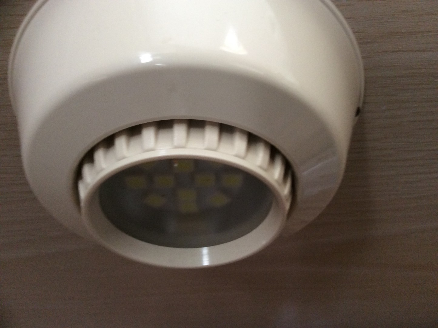

If your lights are the same as this one,remove the bottom plastic flange with your finger nails the glass drops out remove the bulb and fit LED and replace.
Those 'eyeball' type lights are the ones I had. The original bulbs were halogen which gave off a lot of heat scorching the bottom of the fittings, one burnt right through so was close to catching fire. Mine are long gone so I am unable to provide a photo.
I can see that you have LED lights installed - easier to do than the LED bar I have. Still, I think that the LED bar provides more light over the sink and work bench.

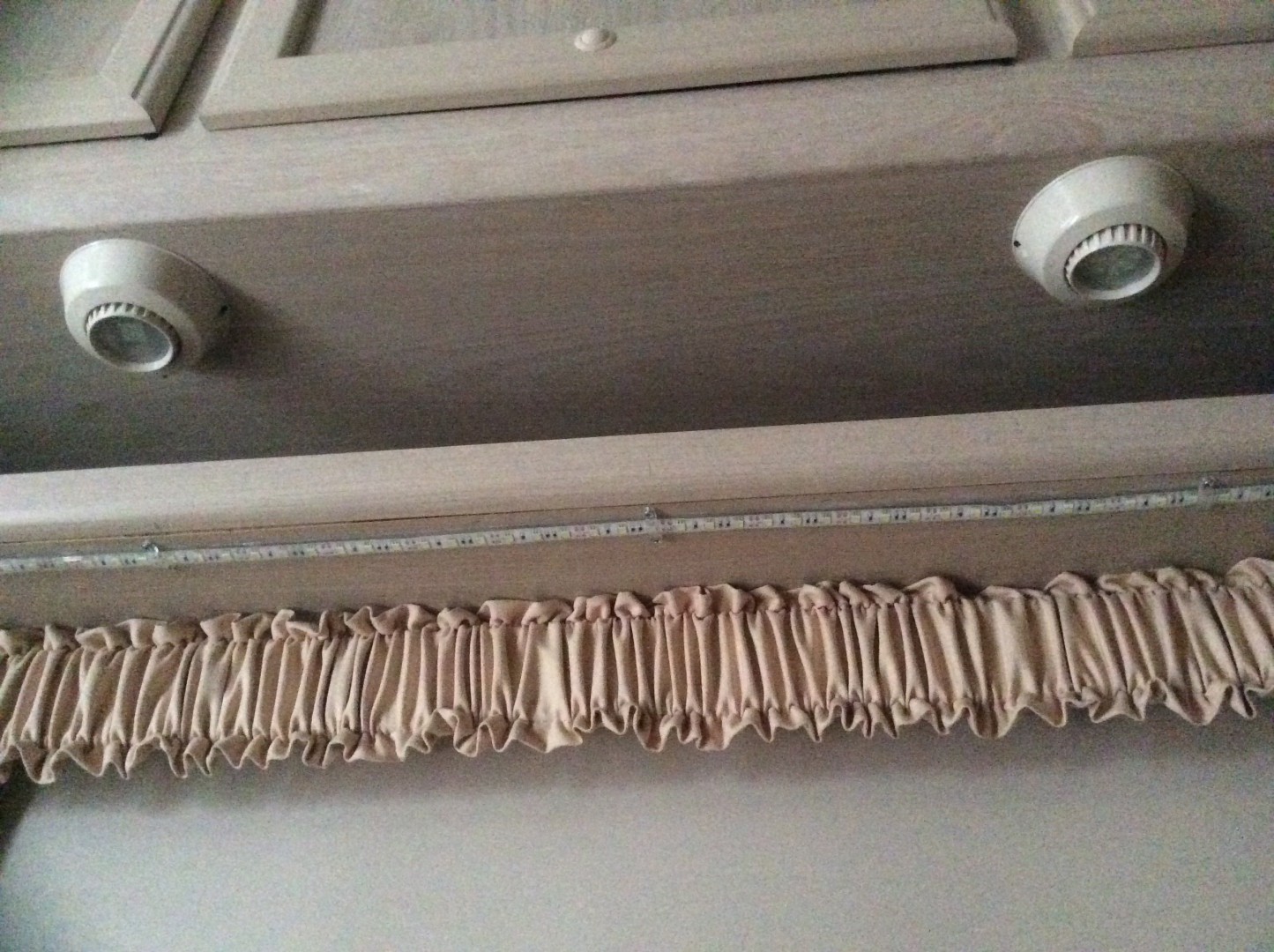

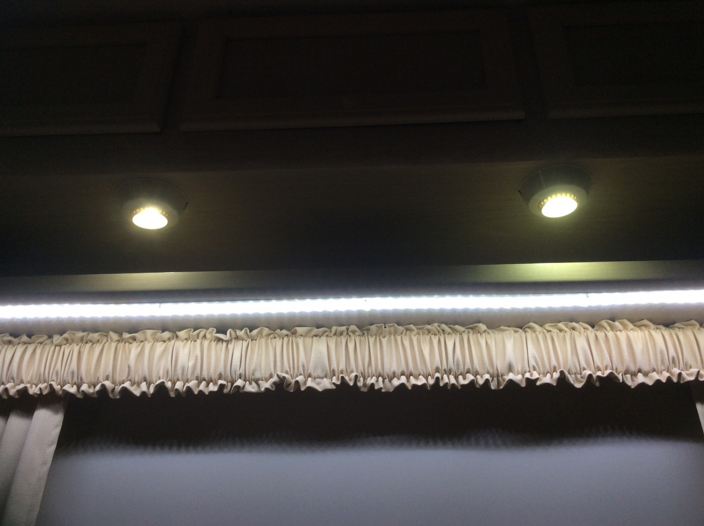

I have added a LED strip for the wife to read buy I don't use the little ones anymore,plus the switch is easier to get at,I also have fitted a LED strip over the sink and also under the glass cabinet on the adj side.

Kev, the easiest way is to upload a pic of your light fitting and we'll be able to tell you how to get the old bulb out and what's the best LED to go into it. The 12 spot LED that Lance posted up are about the equivilant of a 10 watt halogen bulb in terms of light output but only using 2.25 watts power. There are many options going both lighter and brighter just depends on how much light you want.

The LED strip certainly gives out more light than the eyeballs.
Apart from the heat from the halogen bulbs the eyeballs had very cheap and flimsy toggle switches - one fell apart. So rather than mess about putting new switches in I simply replaced the whole light with another type having LED panels.
I also replaced the two halogen bulbs over the stove with LED ones. I wasn't aware that the bulbs came in two different lengths and the first ones I bought protruded below the cover. The next ones were the right length and are held in place by the cover as per the originals.
By the way, I removed that ruffled trim strip on our van. I kept banging my head on it when reading in bed! The trip strip is stored away so that I can replace it if we decide to sell the van - it does look nice if not practicable!

The light bulb replacement that I used was different to what you explained in your link ,I have a pic of the one that I have used ,these replacement LED,S don't have any heat coming off them,the old halogen were very hot.

The bulb and glass are held in place by a ring. While the 'eyeball' looks like one piece the ring is separate and is simply pushed in place and held there by friction. Use a thin knife (or finger nail if it is strong enough!) to work the ring out.

High Peter

Kev,
