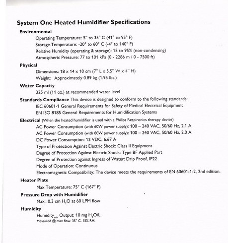

These are the specs of my Philips Respironics REMstar Pro C-Flex+. Unfortunately the strange input has two 12 volt sections for different jobs. Next time I have to order masks etc from the US I will get the 12 volt adapter which is much cheaper. With my 300 watt inverter the inverter fan runs continuously using the heated tube and humidifier, and does not run at all without the humidifier.
