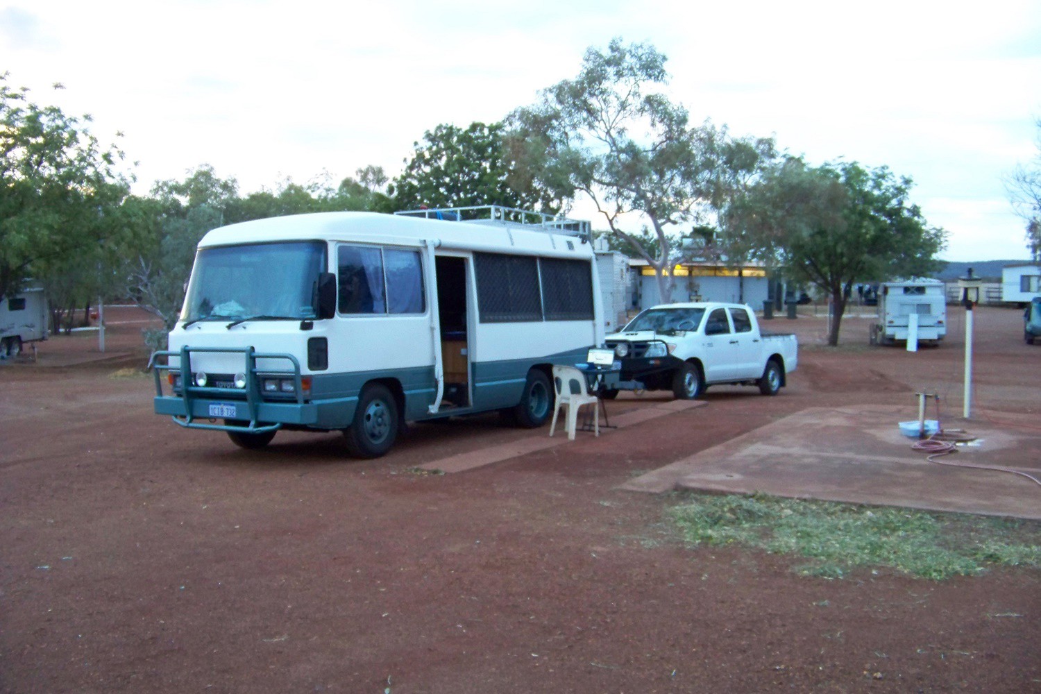

Our old 3B wasn't too bad, would sit on 100 all day everyday but the hills killed it & we towed a duel cab Hilux as the toad so was grossly underpowered in hilly country. Also looked at an engine swap & considered the Landcruiser turbo V8 at one stage. Ended up buying a 1HZ powered LWB instead, SWMBO wanted it, happy wife happy life, but before that happened I went down the path of the turbo to bring it up to 13BT specs as it was a far cheaper & easier option. Turbo exhaust manifolds are impossible to find in Aus or NZ at a reasonable price but there is a bloke in Canada who could ship a kit out to Aus (minus the turbo) for 800 bucks, all new parts custom manufactured to suit the 3B, turbo kit on the net for less than 1000 bucks & a day or three in the shed to fit. At just over two grand & no engineering bull to deal with. A mate went down this path & was very happy with the results, still not as economical to run as the 1HZ but left me in his dust/smoke overtaking road trains & in the hills.
