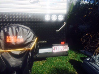

Sol said
05:50 AM Aug 27, 2015
G'day mate, here is a pic of where they have put the number plate on our June 2015 New Age Manta Ray.
if you look closely you'll see where they had the number plate on earlier models above the spare tyre.
When you see tugs and rigs with so many non compliant fittings that the authorities seem to ignore unless it's topic of the month in the squad room a number plate height seems small bickies . Next time your on the road ,in NSW at least, just note how many vehicles are running driving lights above their standard headlights or running fog lights in broad daylight when there is no fog dust or smoke, no one polices that section of motor traffic act .
hope this helps mate.
