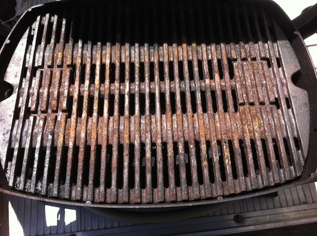

Firstly let me say we love our babyq bbq, and I feel it is by far the best bbq out there, but, I am on my second grill plate now, the first rusted out really bad in just over 3 years, I treated it correctly, no water on it while hot, cleaned and oiled as per instructions but the dreaded rust came through.
Now to Weber's great service they replaced free of charge just under a year ago with the newer 2 piece one, great it looked better and the enamel was thicker so it seemed, but alas yesterday when I went to cook something the dreaded rust spots are breaking through again !
Is it just me or do others have this problem ? is there a prevention ? or do we just keep claiming new grills under warranty ?
As said I clean with the proper weber brush oil with rice bran oil, never put water near it when hot, it's just frustrating to have such a fantastic product let itself down by one thing.

Banjo, by chance do you use a cast iron flat plate for eggs etc on the Weber? Do you leave it on the grill when finished? Just wondering if this may cause your rusting.

I think you may have hit the nail on the head ! I often use the double piece of foil under the trivet, and it sometimes gets left for next day till i remove, I wonder if Its causing electrolysis between the dissimilar metals ?
I also use a cast iron skillet in there but always remove after cooking anyway, did have the Aldi aluminium tepanyaki plate but I dont like the idea of teflon being baked in there, think I will email weber again and send them some photos to see if they have any ideas.
I checked and this new 2 piece grill plate is just 10 months old, but we travel full time and it gets "lots" of use. It's only small spots of rust but I know from the last one that once it starts it's very rapid, will try and post a pic of my previous grill plate.

My last grill plate after it really deteriorated.
I left it dry no oil to send a photo to weber, when brushed and oiled it didnt look as bad, but was still rusty under the oil.
