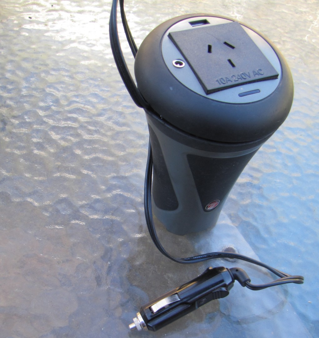

I have a Toshiba laptop with a power supply which says it needs an imput of 240v, 50 to 60htz and 2.0amp.
I am trying to charge it off the pictured laptop car charger/invertor but it wont work.I used to charge my 17" Apple Macbook computer on it no problems.
As soon as I plug the 240v lead into the inverter the little blue light on it goes out and the computer doesnt show itself charging.
The charger/inverter says it pushes out 240v, 50htz and 100w. The caravan battery is on a float charge of 13.7v.
Anyone know what the problem would be or what I am missing please?

you state that your charger needs 2amps at 240V, that would be up to 480 watts, and your inverter is rated as 100 watts, that would be the reason.
Thre would be a couple of options:
1. Get a bigger inverter (recommend at least 600w)
2. Get a 12v laptop charger, they are generally cheaper, and just save the hassle of using an inverter.
I hope this helps.

Jon, I used to have a 180W inverter to charge my Toshiba laptop - usually when in the car. I finally decided it was a bit of a "waste" of energy ... taking 12V and making it 240V and then having the 240V 'adaptor' that comes with the laptop to break it back down to 19V for the laptop
I now have 12v sockets in the van and use this. So now the 12V is changed to 19V and charges the laptop from less than 10% battery to 100% battery within 90mins.
It has an inbuilt 'anti-surge' so it is safe to use it to charge the laptop and to safely use the laptop at the same time.

I would have thought a 12v charger/inverter made specifically to charge laptops would be capable of charging a laptop but I guess I'm wrong.
I was trying to avoid buying a 12v direct to 19v charger because I already have this thing and the one I would have to buy that will manage 19v & 6.3amps needed for this laptop are about $80 each and I needed one for me and one for my wife's computer & on a pension I try to do things cheaply plus, since I have 240ah batteries and 320w of solar spare to use I didn't mind the extra power usage.
The other choice, of course, is to get a 600w pure sine wave inverter.

1st off you dont need a pure sine wave invertor.
Just for the record my Toshiba ac adaptors specs are imput 100-240v @ 2A output is 19v @ 6.32A.
If my laptops SOC is between 90 -100% it happily runs off a 100w beer can invertor BUT it will not advance the charge it will only assist in maintaining SOC.
I would suggest if you want to charge from 12v then get a good 12 to 19v car charger its worth the expense in the long run.
They are available from ebay for $26, its a better option to use it rather than ac power supply and invertor

Though many say that using modified sinewave inverters for a laptop is ok I would never use anything but a pure sine wave inverter as there are just too many experts that say not to risk charging a laptop on the modified one and for my $1000 laptop. It's best to spend a few more dollars to be safe.
To get a 12 to 19v inverter I would need to pay well over $50 if I want one that handles the 9amp that the Toshiba needs. The cheaper ones are around 3amp or below, I have one of those and it doesn't work either.
BTW. I have just bought the charger that Rockylizard recommended but from ebay not Jaycar as it was a bit cheaper -$54.40. (Thanks for the link John I didn't know about those ones).
