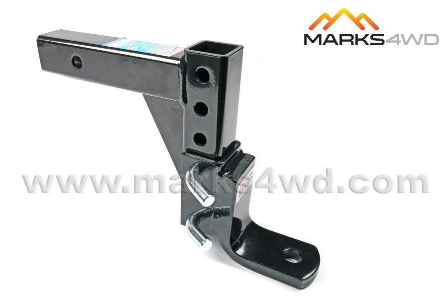

If your van is sitting low in the rear because of the hight of the draw bar on your car you can get adjustable tow hitches that allow you to level out the van and stop the rear dragging.
The Doo crew said
07:53 AM Aug 9, 2015
Sounds like your problem is not the van but your towbar height on your Nissan. Almost any caravan/4X4 shop can supply an adjustable receiver for your hitch giving you the ability to lower the tow ball height possibly eliminating your problem. That is as long as you have a "Reece style" hitch. Might be worth going to your local towbar centre for some advice.

Have you seen or tried one of these?
Hard to figure that you can't get low enough with one of these
-- Edited by jade46 on Saturday 22nd of August 2015 07:26:16 AM
I took the time to look at the lady's ute and caravan photos.
The hitch is not the problem, the van is looking level and possibly a little lower then most single axle caravans.
You could buy a drop down receiver lowering the ball height which would lower the front and raise the back, a quick fix for one problem and then adding more problems. Lowering 20 mm at the front might make a difference enough to get by on.
Like when you are going to unhitch, unable to get your caravan wind up stand under the A frame, chains draging on the road, the A frame hits the curb or speed bumps instead of the rear.
Her van has a long overhang adding to the woe.
Yes the only real way of fixing the problem is raising the vans height would be at the axle.
I like to think there was easy way and economic way. Ralph
