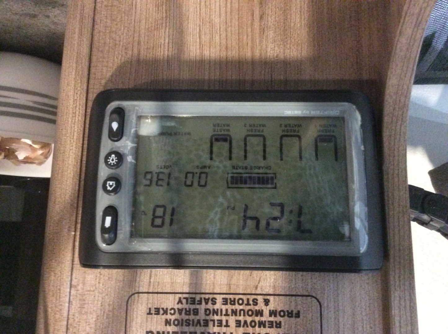

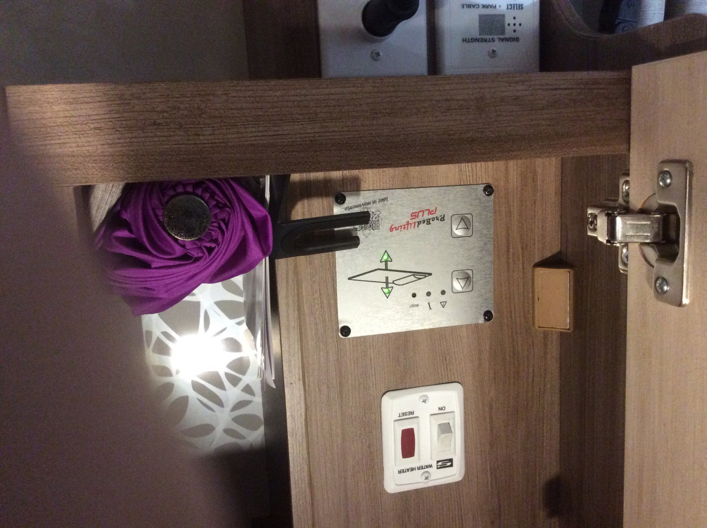

i wonder if a techie out there can answer in "non techie" fashion to a non techie female please.
i have a 2015 Jayco Conquest with a Drifter monitor and my "time remaining" and "amps" are constantly blank despite most things seemingly working OK. However on a couple of occasions my electric bed hasn't dropped down at night and the two lights in the photo stay on all night.
Does anyone know if this Drifter "amps" situation is linked to the bed not dropping, ie the bed may be trying to draw too many amps for the zero amps showing Drifter?
ive been back to the dealer and they assure me it's wired correctly but I'm worried I'm going to be caught out somewhere with the Drifter totally failing me.
appreciate any assistance.

Firstly, do you have a solar panel? If so your drifter will show charging one moment and discharging the next (written over the battery symbol). If not, you battery charger will do that as well, its part of the way the charger conditions the battery. Its not uncommon to show zero like yours, means there is no charging effort to the batteries or discharging going on.
I cant comment on the bed as Im not sure of the details, however if you got a good nights sleep and no bangs or odd smells I would say all is normal. Jayco arent that keen to divulge too much technical info. I have a 2013 Starcraft with drifter and solar so have a fair idea of what looks normal. Yours looks normal.

I just read your post again and saw that the bed is not doing much. I would disconnect the 240 volt outside power cord then switch the battery off (the big switch at the top right of the drifter panel), completely disconnecting all power, wait a few seconds and reconnect everything and see what happens then. Also check the fuse panel, you may have blown the one that works the bed. Again, Im not sure how these things are meant to work. Do you have an instruction booklet for the bed?

The bed power supply can be supplied from a fuse on the Setec (if not too large) or directly from the battery if it draws a large current. Either way the bed should be a separate circuit from the Drifter. All the drifter should do is to measure the current drawn by the bed provided all battery charging is disabled and nothing else is operating from the battery. If you switch any light or the pump on then the current dawn by that (or those devices) will be added to the reading from the bed operation.

I was directing Chris to Jayco for the bed issue. When we picked our van up there were booklets for all the devices in the van, so Im wondering if the bed has its own booklet?
PeterD, this may be a thermal cut out issue, most DC motors I have worked on have a thermal cut out, may be that Chris is putting the bed down and up and the motor is getting a little warm. Only a thought...
Sounds odd to me Chris that after a drive the bed wants to work. Im not that flash with motorhomes so I will bow to the expertise of others who are.
If the dealer is saying all is well and connected properly then the thermal cut out must be questioned. Chris how many times do you put the bed up and down when you test this out?
At 13.6 volts I would guess all is well with the battery. The drifter seems to be doing its job, important to note the sensing wires on the drifter are very small dia and the voltage is not the true terminal voltage of the battery (I have tested that one, out by about .2 volts.).
I would be very keen to see how many times this bed has been up and down..

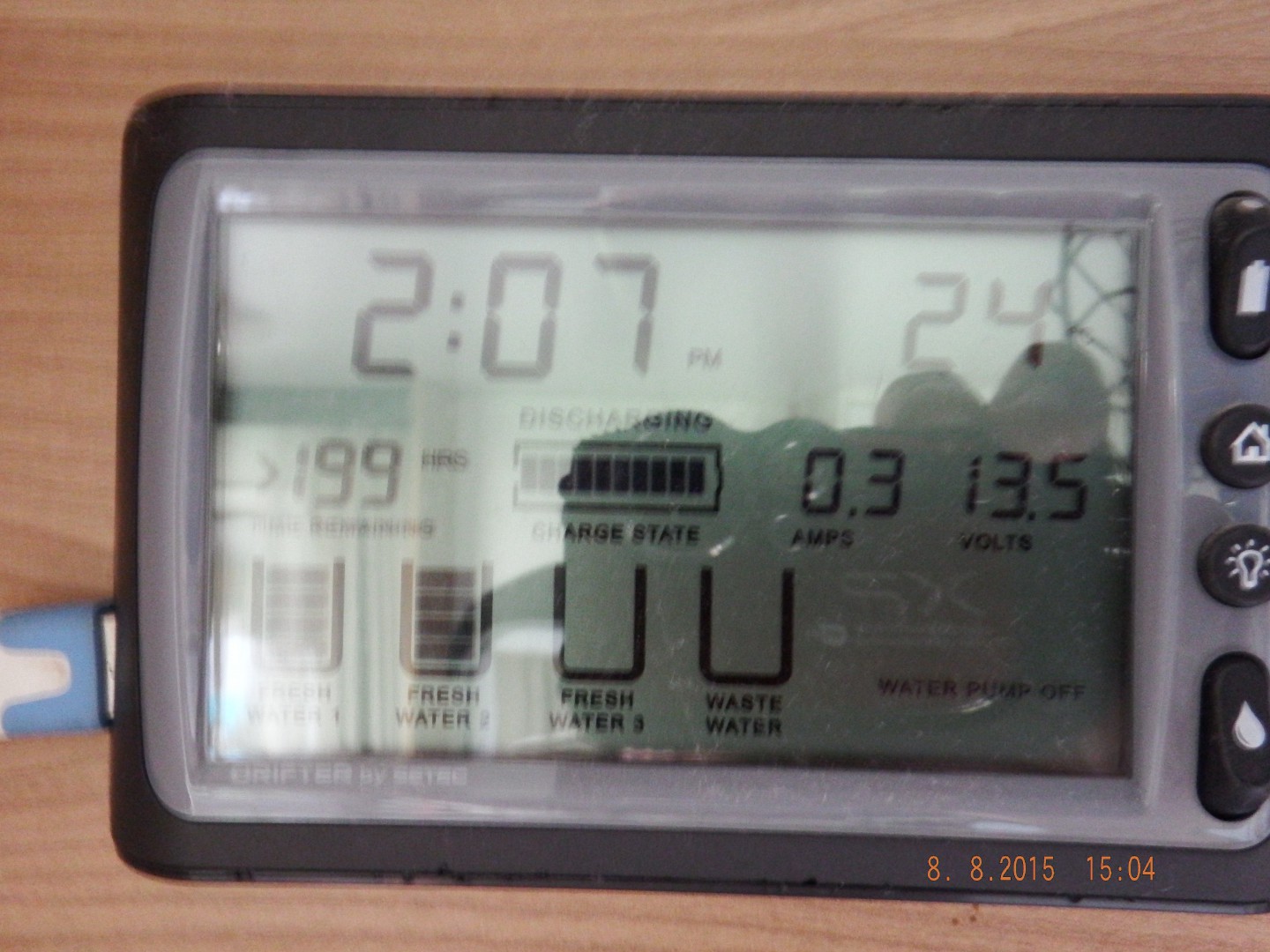

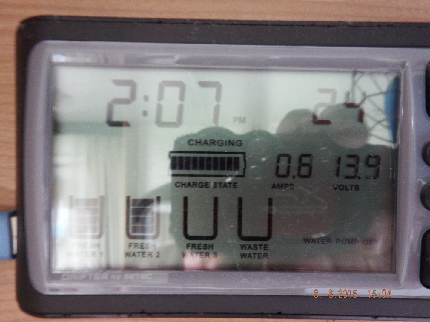

Phil C said
02:45 PM Aug 8, 2015
Just a few pics for Chris one is drifter on discharge and the other on charge

Thanks PHIL. Mine invariably says discharging when I'm parked up. I can't recall ever seeing it say charging. My "hours remaining" can vary from 199 hours to 52 hours to 3 minutes to blank in a matter of minutes. Amps usually 0 when parked up, occasionally 0.2 or 0.3.

If your battery charger (and/or solar charging) is operating there should be a little bit of current showing if your battery is fully charged. If you switch any lights or your water pump on the Setec power supply will provide that current and there should be no change in the current reading. If you wish to use the Drifter current metering to measure the current in the house supply you will have to switch the Setec off (and disable the solar charging if any) so that the battery can supply the total current in the house circuit.

When I'm parked up, "discharging" invariably shows up on the Drifter as well as zero on the amps. I haven't yet used the water pump as I'm always hooked up to power so don't need it.

The battery isolator switch on the Setec is always turned on other than when it's stored for extended periods.

Hi Peter, the drifter has the battery isolate switch on the top right, from the pics it is on and working only when discharging does the drifter show how much time is left.
I was on the understanding that 13.6 was a charged voltage, please correct me if Im wrong as my van is out as well....

Chris, What is the current battery voltage showing on the Drifter.

The voltage on the Drifter seems to regularly sit at around 13.9, there doesn't seem to be an issue with this.

Sounds like a power supply problem to the bed, unrelated to the drifter to me ie -
battery problem, - has a "surface charge" from solar and setec only
bed switch problem - poor connection
bed wiring battery to motor - poor connection somewhere.
One way to check is when the bed fails to move start the engine as this seems to be a part of this and leave it running (with a few revs if you can - say 1,500RPM) and then see if the bed works.
Your battery can show 13.6 V and still not deliver the required current to raise/lower your bed if it is poor condition. My last set of 4 AGM batteries did this and all looked good until they had a load on them and then they died quickly.

i don't believe it's poor switching on the bed or anything related to the mechanism of the bed, as on the two occasions it didn't, drop, both were on the third night of being parked up, as if some battery drainage was happening and providing insufficient "grunt" to get it moving. After driving home the next day on both occasions, the bed worked again, as if it had been powered back up. Someone suggested starting the engine which I did, but that didn't help. Mind you, I didn't run the engine for long, just turned it on and kept it running, walked back and tried the bed again to no avail so switched the engine back off.
There was no bedding or anything catching on to the mechanism to cause the issue.
