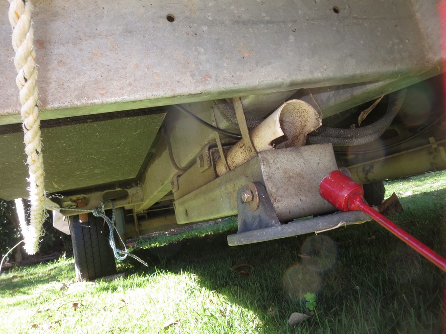

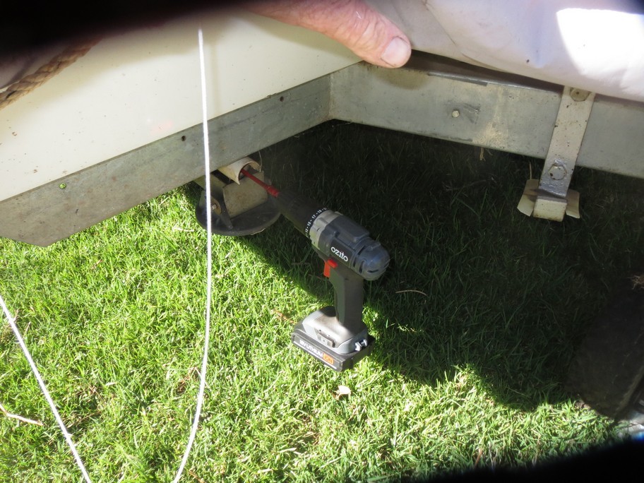

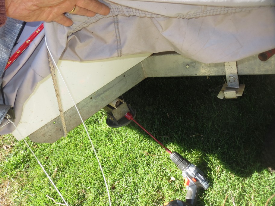

I've simply attached a short length of 25mm plastic pipe to the chassis at each leg to guide the winder to the head - you only have to lean down, insert cordless drill winder in hole a pull the trigger. Simple and cheap. I'd add a picture but it's dark outside.

Took some pics of the setup I use on the Avan - cost is a few dollars for plastic pipe and some straps and easily DIY.
Good modification Dennis. I like the KISS principle.
