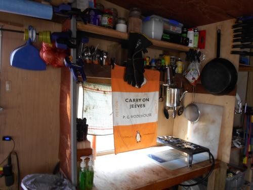

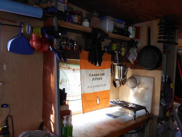

I have built two sturdy walls amidships and will be making sure they are securely couple to the frame. That has added considerable rigidity. A great amount of time goes into rationalising space usage and trying to fit as much as possible in logical places without making the place cluttered and claustrophobic.
Here is the galley (so far) ;
-- Edited by Muzzlehatch on Thursday 3rd of September 2015 05:37:02 PM
