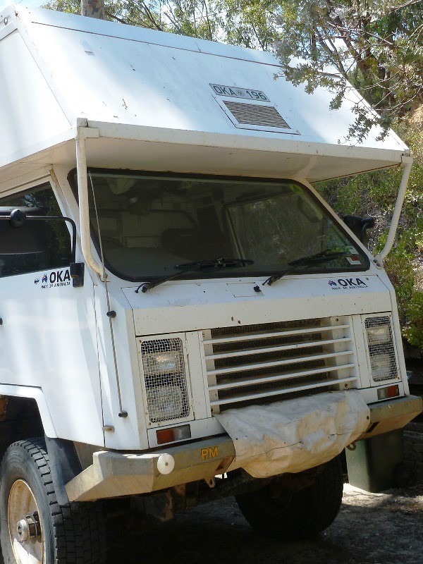

You may not legally seal up the gas vents.
There will be 2, one at low level (usually in the door) and one up high (within 300mm of the roof).
The best way to keep the dust out is to have a forward opening vent on the roof that will pressurise the inside of the van with clean air.
If you hit a pot hole in the road and damage the van, you were driving too fast for the conditions and you are on your own, so that should be incentive enough to take it easy.
Most outback roads have warnings about road conditions that will be sufficient for the local road authority to say "Sorry mate".

Ours is about 300mm x 100mm and has some S/S 'termi mesh' over it to stop bugs getting in. It is also a U bend shape so it can stay open in the rain without getting stuff inside wet. It is permanently open.
I have seen the same effect achieved with some of the standard roof vents that can open to the front.

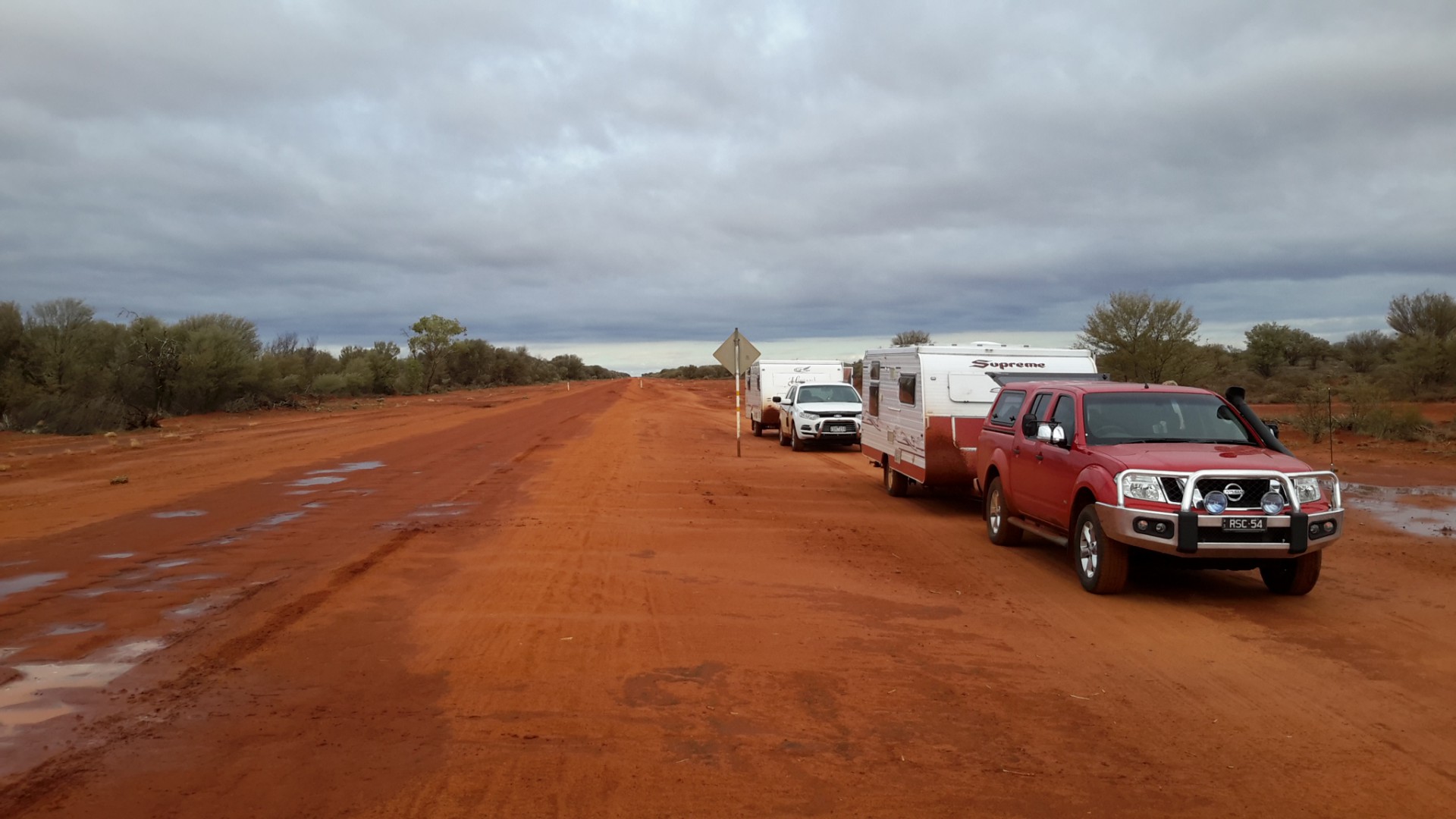

We have found our Supreme basically pretty good as far as dust goes, just keeping the road speed down a bit goes along way to enjoying the experience.
Most tours away from home I find some unsealled roads, our average would be about 10% of our travels, 80% low class secondary roads, most times not as good as a unsealed road and the remainder motorway.
I must put a pressure roof vent in as from experience with ute canopys it works a treat.
The photo is typical of the roads we encounter in our travels, this is Thargamindah to Quilpie 35 ks with 2 standard caravans.

Our first trip in the KK out to Bourke across to Wanaring to Tibooburra to Cameron Corner to Birdsville over to Quilpie on to Charleville to Bollon back down to Hebel to Lightning Ridge to Sydney.
Just fantastic trips that can be done in conventional 2WD. if you drive to the conditions.

The ram air vent is still a great solution for the leaks around the windows and door though.
Hi Peter & Margaret,
The size of vent in the top? Do you have a size to work on, for the X cubic area internally to maximise the pressure.
Regards Jim & Lambie
The size is more related to the other holes than the size of the interior.
-- Edited by Radar on Monday 3rd of August 2015 08:32:04 AM
