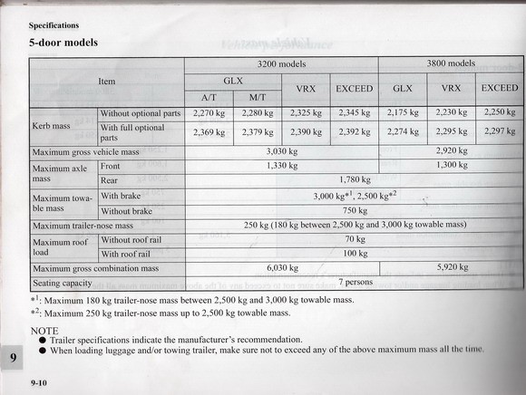

With the Pajero,, better check the ''Ball Weight of the Van ??? I believe at that weight your Recommended Ball Weight is Low ?? But someone else on here might know the full story ??
Meredith said
10:56 AM Aug 1, 2015
We tow with a NT Pajero but our van fully loaded is 2480kg. Anything over 2500kg can't be towed with a Pajero unless it has a ball weight under 180kg, which is low for a large van. We have towed it over 50k, around most of Australia. Our car handles our van well, but it does feel it on large hills, and we don't get as good a fuel economy as Aussie Paul, averaging between 18 and 20 litres per 100l, even more with head winds. Considering our fuel economy is around 9 litres per 100kg not towing around town its a big jump when towing. I think a heavier van could really be pushing the Pajero's towing limits, even if you could find one with a low enough ball weight.

Thanks everyone for your quick feedback. Just to make things a little clearer (my fault). We are considering buying a JB caravan 20'6" Dirt Roader (semi off road van). This particular van has a rear door side entry which apparently reduces the tow ball weight to between 120 and 140 kgs. The same van in the yard at Caboolture has a recorded tow ball weight of 120 kgs, a tare of 2308 kgs and an ATM of 2708 kgs. The van we are considering will be the same except for the addition of a grey water tank and a tool box on the A frame. All the other models of the Dirt Roader, with the exception of the 17'10" van, are over the 180 kg tow ball limit. This is still a fair bit under the maximum towing capacity of the Pajero rated at 3000 kgs. We are aware of the 180 kg max tow ball weight restriction of the Pajero when the van is over 2500 kgs hence the reason for considering the 20'6" Dirt Roader.

The tool box once you have anything in it will definitely increase the ball weight. Its just my opinion, but going from how our Pajero (which we really like) tows the 2480 I do think adding a few hundred more kilos could be really pushing it limits engine wise. We also have had to replace our suspension on the Pajero as towing that weight that much has pretty much wrecked it. We have towed my brother in laws around 3000kg van with his Landcruiser and you really do notice the difference in how easily the Landcruiser handles the weight.

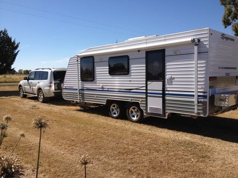

moamajohn said
10:24 AM Aug 2, 2015
2012 Supreme Classic. Mc Hitch auto coupler, ESC normal on roader no frills.
Hi Meredith your van sounds similar to the JB Dirt Roaders where they are not designed for extreme "off road" but can be towed on reasonable dirt roads for considerable distances eg national parks and some more remote free camping sites. And Westy your van looks big but I assume the weight is kept to a manageable level for the Pajero because it is not built as an "off roader" or "semi off roader". I've noticed when comparing the various weights of on road vans against off road vans that there is a considerable difference with the off road vans being a lot heavier due to their more rugged construction and extra "stuff". So to cut a long storey short and so I don't bore you both with my ramblings, we are looking at a 17'6" JB Dirt Roader on Wednesday which may just suit our needs better and take away the uncertainty of the weight issues and the resultant strain on the Pajero. After all, the whole experience is supposed to be as stress free as possible and the last thing we need is to be worried about is towing the van. Thank you both s once again for your valuable feedback.
