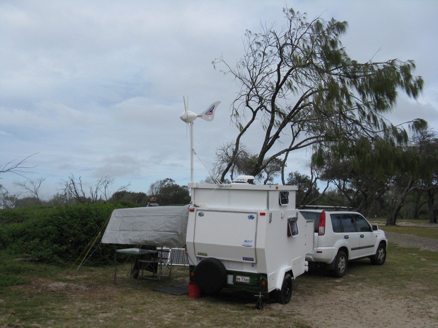

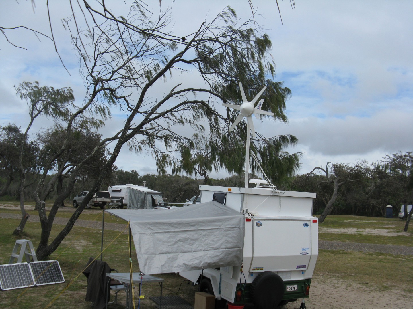

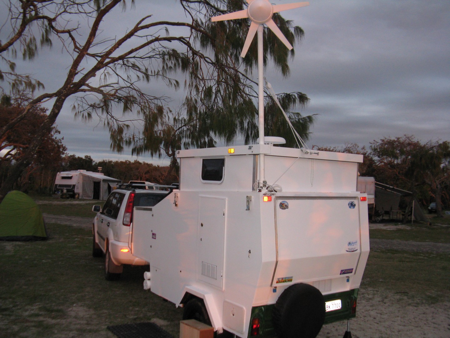

After major changes MY BEACH SHAK is back on the road.
Pop Top 50% lighter and folds up/down easy.
Front Extension slides out and locates better but will be further improved next summer by making it 800mm
Power is now two circuits.
Circuit 1 - 2 x 100ah Deep cycle in parallel charged by DC-DC charger when driving. 160W solar or Rutland Wind Generator (or both) when camping.
Circuit 2 - 1 x Ordinary car battery (To be replaced by a 100ah Deep Cycle when I can)Charged by 160W solar and/or Wind Gen as required. This circuit connects to 600W invertor
When considering the Wind Generator I researched several Chinese models available - Cheap but most needed winds of
45 klms/Hr for any decent output and are 1.2M Dia.
Spent a few days on Noosa North Shore last week and everything is working well so will be travelling further soon.
