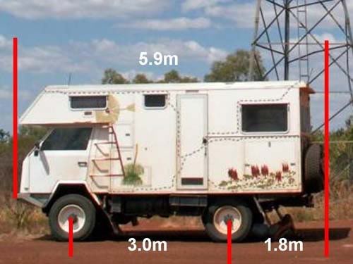

For motorhomes...
Anything on the back (including my spare wheels in this pic, or bicycles etc) is included in the overhang and the same applies to caravans.
In the above case, 1.8m is the maximum overhang (60% of the wheel base).
3.7m is the maximum overhang irrespective of wheel base.

For motorhomes...

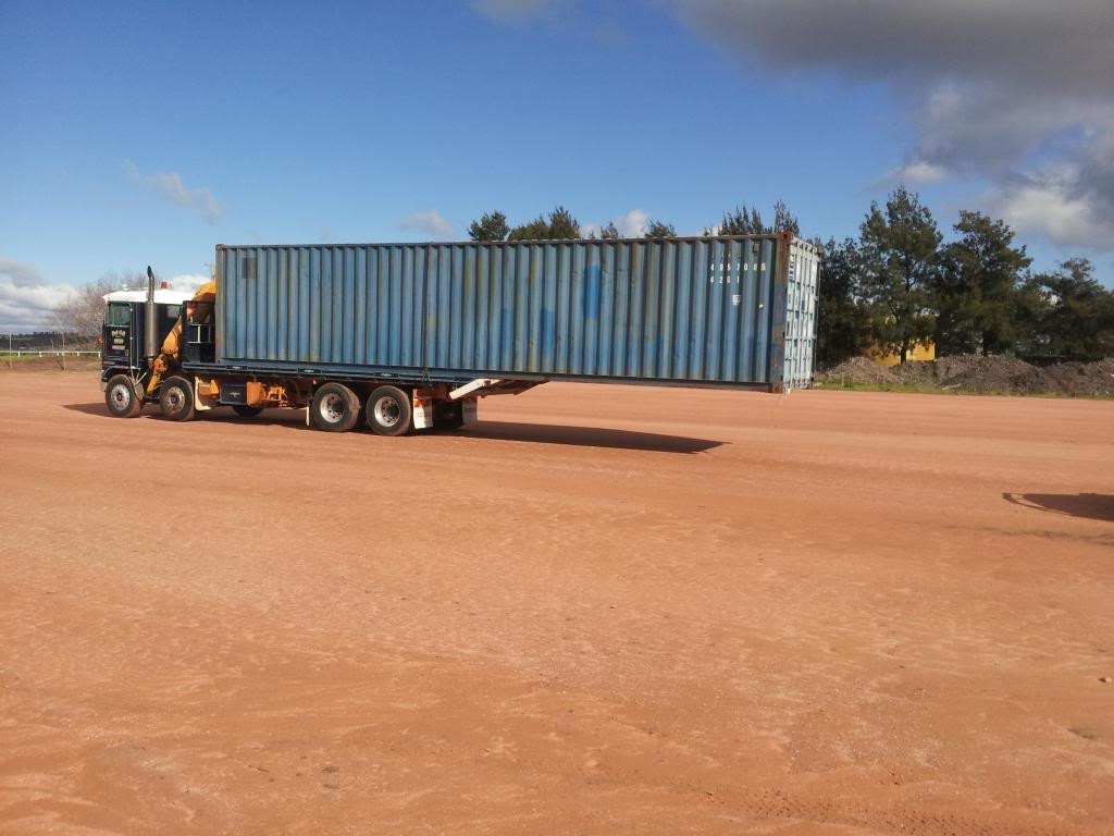

this might be why they don't like "overhang"
