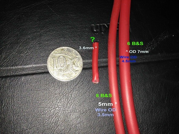

A couple of months ago I bought some 6 B&S cable, well that is what I asked for. Today I went to buy around 15 meters of 6 B&S for van projects and the guy showed me several pieces that did not match what I thought was 6 B&S!!! He gave me a couple of samples of 6 and 8 B&S. The short bit is what I was given couple of months ago as 6 B&S!!!!
The one on the left looks like plain old 6mm cable Paul.
I reckon Doug. I did not give the incorrect info, they heard it WRONG!!!!!!!!!!! Glad I did not buy a 100 mtr roll of it!!!! Ah ha the joys of learning about our rigs!!!
I remember this time last year Paul, I put the Collie in to get something done at TJM and asked for 6B&S cable and that I know the difference. When I went to pick up the Collie crawled in underneath to check the job and BINGO not 6B&S. I said to please do as I asked. They said it is what they normally use. I said do what I am paying for. All changed and off I went a happy camper IN THE END.

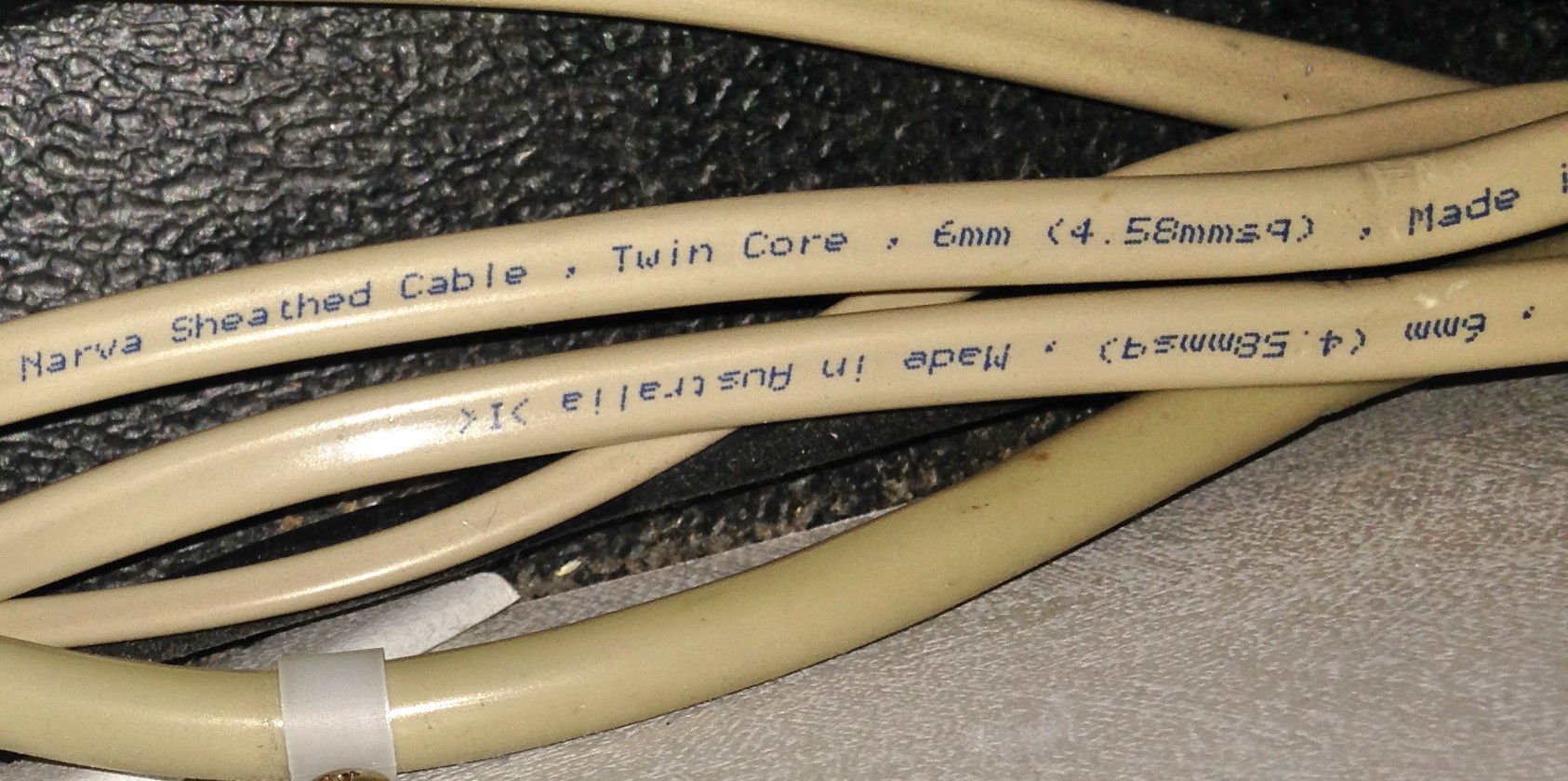

aussie_paul said
01:37 PM Jul 24, 2015
This is the wire that Jayco have installed our 2011 Sterling.
Good photo Paul,,, BUT what do these wires go to is the important question?????
Also what current are you expecting ie 2A for lights or 15A for fridge etc??
aussie_paul said
10:06 PM Jul 24, 2015
Baz421 wrote:
Hi Barry, one of those wire is between the batteries and the Setec charger, so all the van current comes and goes through that wire when not connected to 240V power. The second wire goes to the fridge from the tug, and the 3rd is the Setec aux input from tug. The couple of thinner wires are for water tank level indicators and the round wire is the 240 AC.
I have paralleled the fridge and Setec aux wires to only run the fridge, so doubled the amount of wire to the fridge. I now plan to run 6 B&S between the batteries and the Setec charger. Next Wednesday I am having a 6 B&S added to the tug to charge batteries via a DC to DC charger. I already have an 8 B&S fitted to the tug via a battery isolator, and that will now feed the fridge.

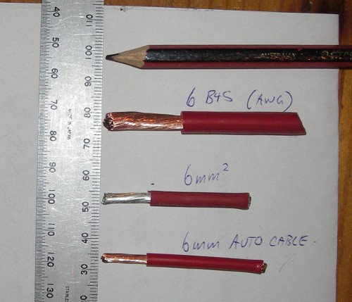

Here's a chart to help I hope.
http://www.engineeringtoolbox.com/wire-gauges-d_419.html
Thanks Barry.
Here's a pic I posted on here ages ago somewhere.
